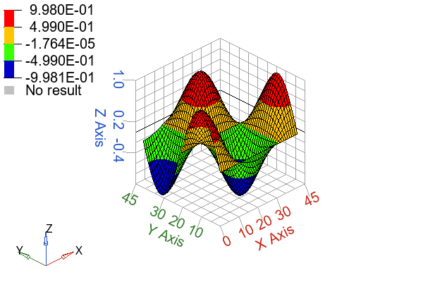

Figure 1. 3D contour plot
Number of contours example:
cla;
x=[0:0.15:2*pi];
y=x;
z=sin(x')*cos(y);
contour3(z, 4);
colorbar;
Figure 2. 3D contour plot with four color levels
