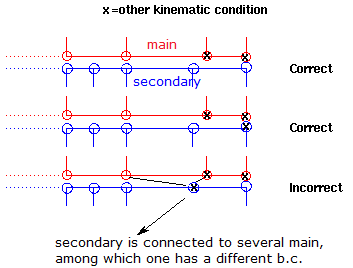

Rule 4:
Kinematic conditions on the secondary side are allowed only if consistent with an identical condition on the main side.
Figure 4.
This has to remain true when interface slides.

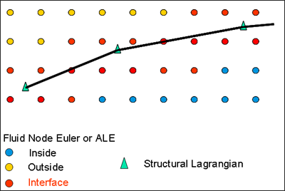

Interface TYPE18 (CEL)
Interface TYPE18 creates contact between Euler/ALE nodes and a Lagrangian main surface. Visco-elastic penalty method is used to impose a relative material (fluid) velocity tangent to the main surface. The grid velocity is not modified by this interface. The interface allows the simulation of the penetration of a Lagrangian part (structure) into an Euler/ALE mesh, for example in the case of ship slamming.
The quality of simulation results using this interface depends strongly on the interface parameters and especially on the stiffness of the interface.

    Figure 6. Fluid-Structure Interaction with Interface TYPE 18
The recommended gap value is equal to 1.5 by the element size. Note that the interface needs a fine enough mesh to provide appropriate results.
