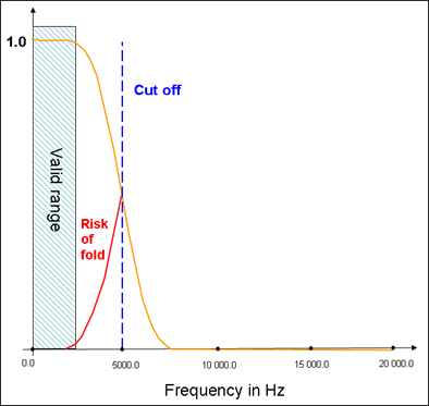

High frequency cutoff is performed above Nyquist frequency to avoid frequency folding in the discrete Fourier transform. Numerical filtering is performed using coefficients of a classical linear phase filter.

- Number of coefficients: 1320
- Base computational frequency fc = 1/dtc = 2.22 10^6 Hz (dtc, critical time step)
- Sampling frequency for output fs = 10040 Hz
- Nyquist frequency or cut off fcut = 5020 Hz
Figure 1. Filtering Example
