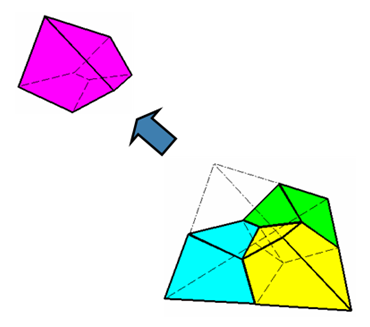

Only hexahedron elements (or quad elements in 2D analysis) are compatible with the ALE or Eulerian formulations. To create the mesh, the usual technique consists in meshing at first outer surfaces of each considered domain with triangles, then generating automatically an internal volume tetrahedron mesh and finally split the tetra's in four hexa each (watch closely the number of elements). Triangle mesh size should be 3.5 times larger than the planned mesh size for tetrahedral.
Figure 1. Tetrahedron Transformed to Hexahedron Mesh

For boundary layers, the wall element size is determined as explained in Wall Element Size. The mesh for boundary layer is generally obtained by meshing the wall surface using triangles. Then, by extruding the surface mesh, a solid pentahedron mesh is created. The pentahedron elements can afterward be split easily to hexahedrons, as shown in Figure 2.
Figure 2. Split of a Pentahedron Element to Three Hexahedrons

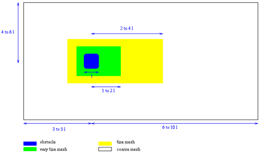

Consider the case of airflow passing over an obstacle is studied (Figure below) where the aim of the simulation is to measure the noise generated by this flow in any location of the mesh. The mesh should have at least four different regions (refer to Mesh Generation):
  • Coarse mesh (all the computational domain except the immediate surroundings of the obstacle)
  • Refined mesh (close to the obstacle)
  • Inlet element (one row of elements)
  • Outlet elements (one row of elements)
With l being the characteristic size of the obstacle in the flow, there are typically three different mesh zones:
Zone Typical Size of Elements Note
very fine a Chosen such as the obstacle is descretized with a minimum of 20 cells in each direction.
fine 2a to 3a
course 4a to 6a Make sure the course cells are appropriate for convection of the highest frequencies of interest.
