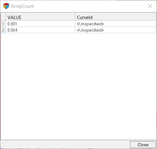

Create a Dummy XY Curve
In this step, you will create a dummy XY curve to be used to create a *DEFINE_TABLE.
Create a *DEFINE_TABLE
In this step, you will create a *DEFINE_TABLE from the dummy curve created in Create a Dummy XY Curve.
