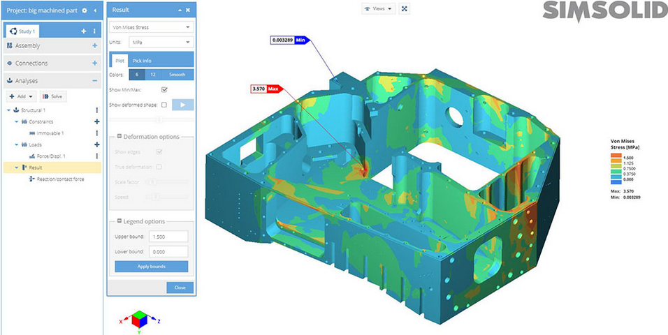

Overview of results displays available in SimSolid Cloud.
To plot a contour make sure the Plot tab is selected, then
simply pick a result type and units. The following additional displays are
available:
Show min/max – Displays the Max and Min labels on the model. The labels
remain fixed during model rotation but may be selected and dragged to
position them.
Show deformed shape – Shows the contour on an exaggerated deformed shape.
Pick the Animate button or drag the slider to manually see the deformed
model envelope.

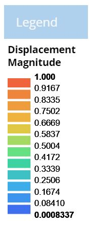

Legend Options
Under the Legend options section of the Plot tab, the following options are
available:
Upper bound & Lowerbound – adjust to scale the legend.
Apply bounds – select to update the legend. This is result quantity
dependent and is temporary. When a new quantity is selected or the result
dialog is closed these values are reset.
Lock the Legend - Set upper and lower bounds in the legend and lock them.
You can use this to retain the same bounds values when switching between
load cases.
You can drag the legend to any screen position by using the mouse to drag the
title bar.Figure 2.

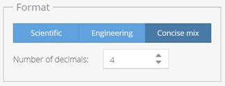

Customizing Numeric Formats
Under (Settings) > Units panel, you can set how numbers in the Results panel are
displayed.Figure 3. The following formats are available:
Scientific – This uses scientific notation. An example is: 1.2345e+3
Engineering –This uses standard numbers. An example is: 0.1234. Be careful
when using this format as very small numbers, such as displacements, may be
rounded to all zeros.
Concise Mix – this attempts to use Engineering format but switch to
Scientific when the scale is too small. This is usually the preferred method
to use.
