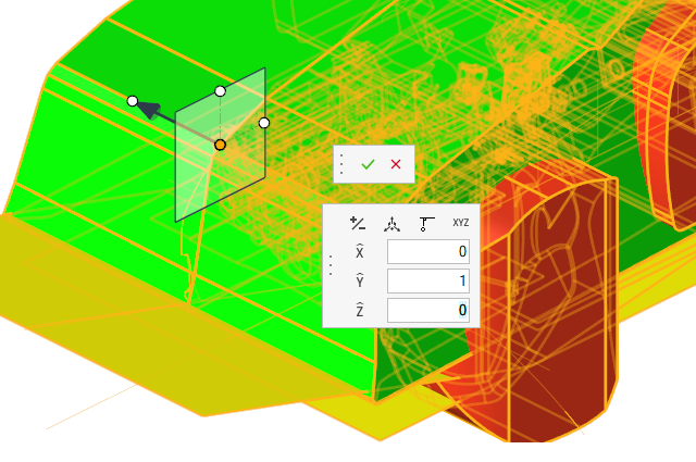

- Click Symmetry on the guide bar.
- Right-click in the modeling window and select Create New.

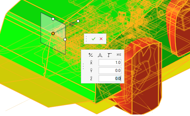

Select the node shown below as the origin of the vector tool.
Figure 4. -
Input 0,1,0 in the X, Y and Z fields
respectively to orient the vector then click
The direction of vector tool decides which is the parent side – in this case, the left hand side is the parent since the vector tool is pointing to the right.
Figure 5.

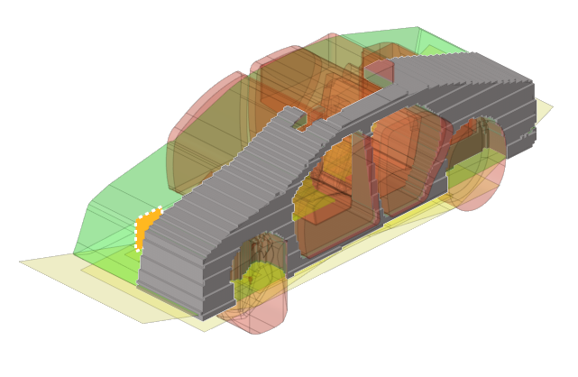

Click Create on the guide bar to
generate the voxel mesh.
Figure 6.
