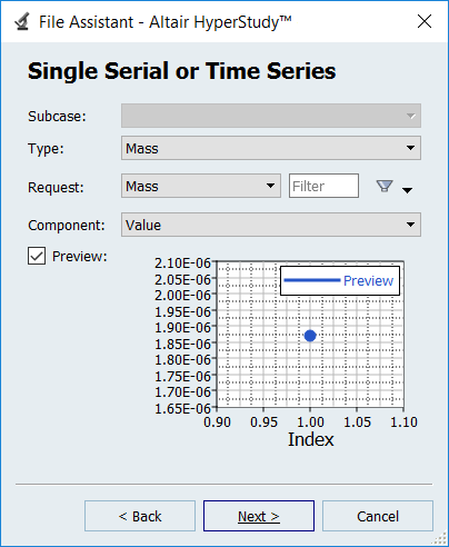

In the File Assistant dialog, set the Reading
technology to Altair® HyperWorks® and click
Next.
Select Single Item in a Time Series, then click
Next.
Define the following options, then click Next.
Set Type to Mass.
Set Request to Mass.
Set Component to Value.
Figure 10.
Label the output response Mass.
Set Expression to First Element.
Note: Because there is only a single value in this data source, [0] is
inserted after m_1_ds_1, thereby choosing the first (and only) entry
in the data source.
Click Finish.
