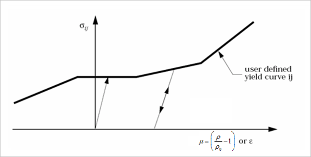

Figure 1. - All element degrees
of freedom are fully uncoupled.
Elastic case example:
- For each tension/compression and shear direction, the true stress as function of a
true volumetric strain
, or a true strain
can be specified.Sign conventions for strain are:
Figure 2.The stress values should always be positive. The following sign conventions for strain are used:Strain Definition Compression Tension Volumetric strain (Iflag1 =0) + - Strain (Iflag1 =1) - + Strain (Iflag1 =-1) + - - For large strain formulations defined
in the property using Ismstr > 1:
(1) For small strains defined in the property using Ismstr = 1:(2) Where, is the initial length.
- When switching from a volumetric strain formulation to a strain formulation, Iflag1 = -1 or Iflag2 = -1 allows the same function definition to be retained.
- If one of the tension strain or shear strain failures is reached, the element is deleted.
