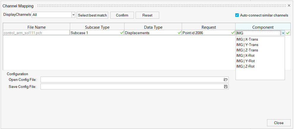

Channel Check
Validate Channels
Use Channel Check to add flexibility to HyperGraph by reconciling reports with mismatched channels.
After loading and selecting a report template from the Report Templates list, select one of the following Channel Check options from the Flexible Reports dialog, and click Apply.
Validate Channels
The Channel Mapping dialog is displayed if there is a mismatch among type/request/components. From the Flexible Reports dialog, you can also click the check mark, , to display the Channel Mapping dialog.
HyperGraph checks the subcase type, data type, request, and component values between the files and displays the matched and unmatched channels in the dialog. All channels referring to a file can be skipped, and you can check and reconnect their types, requests, and components if there is a mismatch. If there is an unmatched channel and you select a component from one of the drop-down menus (Subcase Type, Data Type, Request, or Component) to correct it, HyperGraph automatically fixes the other mismatched components. Mismatched channels are displayed with a red x next to them, . A green check mark, , indicates a match.
Figure 2. Channel Mapping dialog with unmatched channels
Figure 3. Channel Mapping dialog with mismatched channels
Figure 4. Channel Mapping dialog with matched channels
Select Best Match
The Channel Mapping dialog is not displayed. Instead, a best-match algorithm runs in background to match the type/request/components if there is a mismatch. You can also perform this operation using Select Best Match icon, , from the Flexible Reports dialog.
Skip Validation
The Channel Mapping dialog is not displayed, nor does it use the best match algorithm in background to match the type./request/components if there is a mismatch; it plots the signals as-is.
Filter and Sort Data Lists
The Channel Mapping dialog contains filtering and sorting functionality to facilitate matching the Subcase Type, Data Type, Request, and Component channels, along with other display and filtering options related to the lists that are displayed in the fields. Wild card support is not available.
Display Channels
All displays all channels.
Matched only displays the matched channels.
Unmatched only displays the unmatched channels.
The following options are available at the top of the Channel Mapping dialog.
Select Best Match
Inserts the best matches into the selected fields, according to the matching algorithm. The results are sorted using a string match to the shortest distance. The icon to the right of the field changes from this, , to a yellow star, , upon selecting this option.
Confirm
Click Confirm to approve the current best match selections. The icon displayed in the the selected fields is updated from this, , to this, .
If you do not confirm the best match results, and you exit out of the Channel Mapping dialog and return to it later, the best match results are no longer sorted and displayed. You will have to redo this operation.
Reset
Resets the fields to the default, or previous, selections. The and icons return to the .
Auto-connect similar channels
This option is on by default. If you want to manually correct one or more channels without similar channels updating automatically, deselect the Auto-connect similar channels option.
Note: If you reselect Auto-connect similar channels before saving your selections to a config file, and you attempt to a match a channel, all similar channels are mapped, and your previous selections are overridden.
