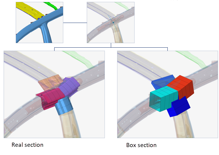

Create Joint Hubs
Use the Joint Box tool to define junctions in your skeleton model.
  1. From the Skeleton ribbon, click the Joint Box tool.
  2. Select the node or elements around which to create a bounding box.
    Any elements found within the box are used for joint creation.
  3. Click on the guide bar to define options.
    Create joint box
    Use the box as a mechanism to select elements to generate the joint location and legs.
    Remove joint legs
    Create a joint without the corresponding legs.
    Mesh member joint
    Automatically create 1D mesh on the joint legs and apply the beam sections.
