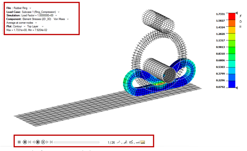

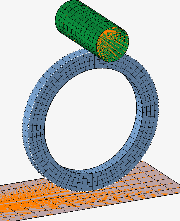

OS-SL-T: 1000 Nonlinear Analysis of Rubber Ring
This tutorial demonstrates the creation of finite elements on a given CAD geometry of a rubber ring.
Application of boundary conditions and a finite element analysis of the problem are explained. Post-processing tools are used to determine stress developed during crushing and sliding of a rubber ring.
The following exercises are included:
- Set up the problem in SimLab
- Apply Loads and Boundary Conditions
- Solve the job
- View the results

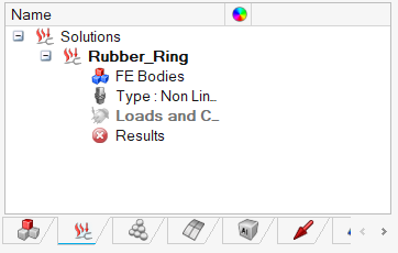

Create Solution
From the Solutions ribbon,
Physics group, click the
Structural tool.
A Create Solution dialog opens.

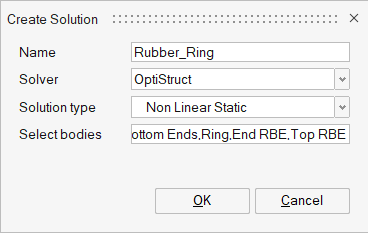

In the Create Solution dialog, define the following
options:
- For Name, enter Rubber_Ring
- For Solver, select OptiStruct.
- For Solution type, select Non Linear Static.
For Select bodies, select all the bodies from the Model Browser and click OK.
Figure 1. Solution Creation
Figure 2. Solution defined in Solutions Browser

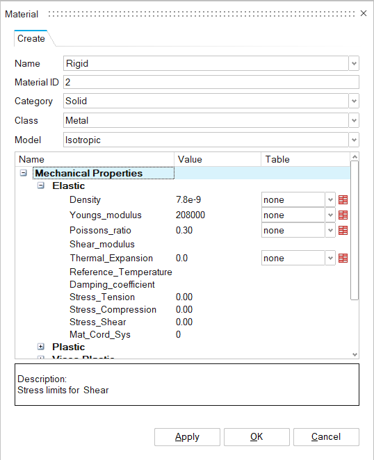

Import Material
- In the Property tab of the Model Browser, right-click on Materials and select Import from the context menu.
In the Open dialog, select the
Rubber_Material.xml file and click
Open.
The Rubber_Material and respective data tables is added to the current materials list.
From the Analysis ribbon,
Property group, click the
Material tool.
A Material dialog opens.
Enter the values, as shown below and click OK.
Figure 3. Creating Rigid Material

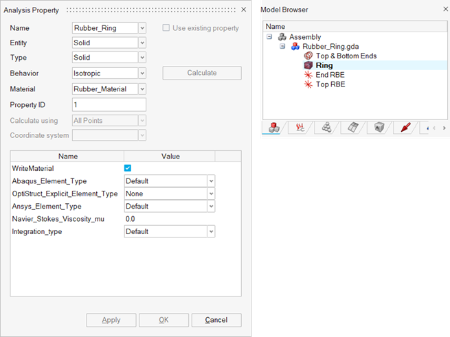

Create Properties
Property tool.
A Analysis Property dialog opens.
In the Analysis Property dialog, enter the values shown
below.
Figure 4. Create Rubber_Ring Property -
Assign property to Ring.
- In the Assembly tab of the Model Browser, select Ring.
- In the Analysis Property dialog, click Apply.
Figure 5. Assign Property to Ring -

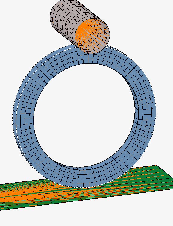

Create a property for Top and Bottom Ends.
- Enter the values in the Analysis Property dialog, as shown below.
- In the Assembly tab of the Model Browser, select Top & Bottom Ends.
Figure 6. Assign Property to Top & Bottom End -
Create property for RBEs.
- In the Assembly tab of the Model Browser, select Top RBE and End RBE.
Figure 7. Assign Property to RBEs

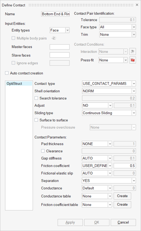

Create a contact between Bottom End & Ring.
Set the following parameters in the Define Contact
Figure 11. Contact Creation between Bottom End and Ring -

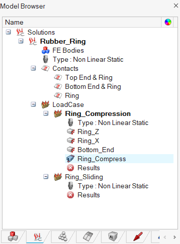

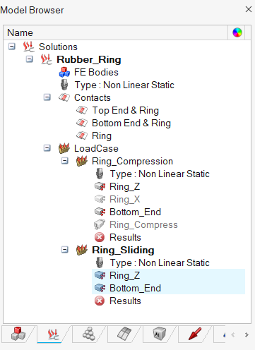

Create Loadcases
- In the Model Browser, click the Solutions tab.
In the Solutions tab, right-click Rubber Ring and select
Define using Load case from the context menu.
A Non Linear Static loadcase type is created.
Right-click on the created loadcase (Loadcase1), select
Rename from the context menu,
and enter Ring_Compression.
The Loads and Constraints pertaining to simulate the Compressing action on the Ring will be added in the Ring_Compression loadcase.
Create an additional loadcase.
- Right-click on LoadCase, and select Create Loadcase from the context menu.
- Right-click on LoadCase2, select Rename from the context menu, and enter Ring_Sliding.
- Verify Type is set to Non Linear Static.

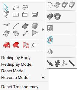

Right-click in the modeling window and change the
selection filter to Face.
Figure 17. Face Selection Filter - From the Analysis ribbon, Loads and Constraints group, click the Constraints tool.

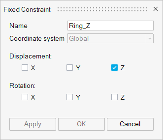

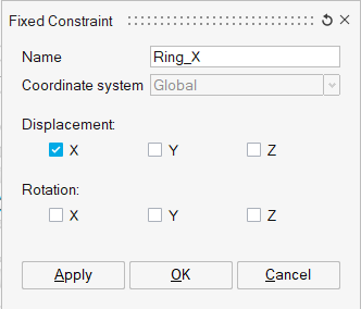

In the Fixed Constraint dialog, set the Axes as shown
below.
Figure 18. Constraint for the Ring Body Along Z Axis -
In the modeling window, select all four faces of the
Ring body and click Apply in the Fixed
Constraint dialog.
The constraint is added to Ring_Compression loadcase.
selection filter to Node.
Figure 19. Node Selection Filter -

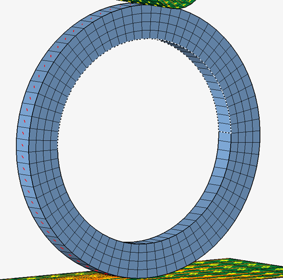

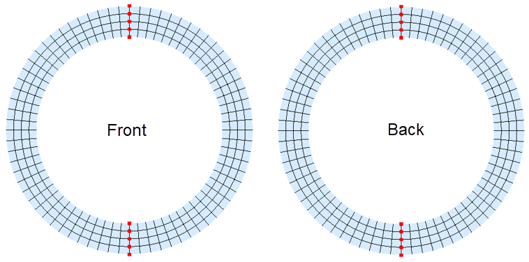

In the modeling window, select the Nodes on the front
and back sides of the Ring body, as shown below.
Figure 20. Node Selection for “Ring_X” Constraint -
below and click Apply.
Figure 21. Constraint for the Ring Body Along X Axis -

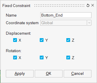

below and click OK.
Figure 24. Constraint for the Bottom End Body
Figure 25. Constraints are added to the Ring_Compression LoadcaseA

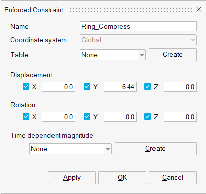

Apply Enfored Displacement
From the secondary tool set, select the Enforced
tool.
The Enforced Constraint dialog opens.
selection filter to RBE Node.
Figure 26. RBE Node Selection Filter -
In the modeling window, select the RBE Main Node of the
Top RBE, as shown below.
Figure 27. Top RBE Main Node -
In the Enforced Constraint dialog, define the parameters
Figure 28. Enforced Displacement for Ring_CompressionThe Enforced Displacement is added to the Ring_Compression loadcase.
Figure 29. Enforced Displacement Added to Ring_Compression Loadcase -
Add constraints to the Ring_Sliding loadcase.
- In the Solutions tab of the Model Browser, right-click on the Ring_Sliding loadcase and select Set Current from the context menu.
- Right-click the Ring_Z constraint under Ring_Compression, and select Add to current Loadcase from the context menu.
- Right-click the Bottom_End constraint under Ring_Compression, and select Add to current Loadcase from the context menu.
The Ring_Z and Bottom_End constraints are added to the current Loadcase.
Figure 30. Ring_Z and Bottom_End Constraints Added to Ring_Sliding Loadcase - Repeat steps 1 through 3.

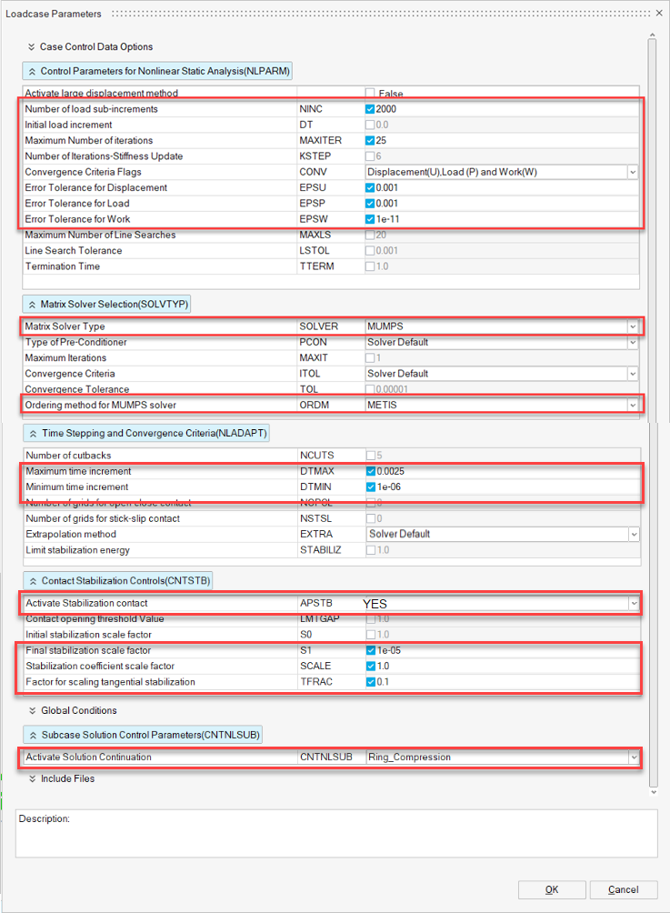

Define Loadcase Parameters
the Ring_Compression loadcase and select Loadcase
Parameters from the context menu.
The Loadcase Parameters dialog opens.
In the Loadcase Parameters dialog, set the values as shown
below and click OK.
Figure 34. Set the Values for Loadcase Parameters for Ring_Compression Loadcase -
Create Loadcase parameters for the Ring_Sliding loadcase.
- In the Solutions tab of the Model Browser, right-click the Ring_Sliding loadcase and select Loadcase Parameters from the context menu.
Figure 35. Create Loadcase Parameters for Ring_Sliding loadcase

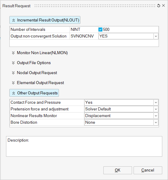

Create Solution Parameters and Output Requests
on the Rubber_Ring solution and select Solution
The Solution Parameters dialog opens.
In the Solution Parameters dialog, set the values as shown
below and click OK.
Figure 36. Set Values for Solution Parameters -
on the Rubber_Ring solution and select Result Request
The Result Request dialog opens.
In the Result Request dialog, set the values as shown
below and click OK.
Figure 37. Set Values for Output Request

The solution begins to solve. After solving, the results are automatically loaded back into the database. After the solving is completed, the results are loaded into SimLab and the results for the final loadcase are displayed by default.
on Results under the Ring_Compression loadcase and click
Display.
The results for the Ring_Compression loadcase are displayed.
- Optional:
Change the Results components using the Results panel at the top of the
modeling window and animate the results using the
Animation panel at the bottom of the modeling window.
Figure 38. Results of Ring_Compression Loadcase -
on Results under the Ring_Sliding loadcase and click
Display.
The results for the Ring_Sliding loadcase are displayed.
