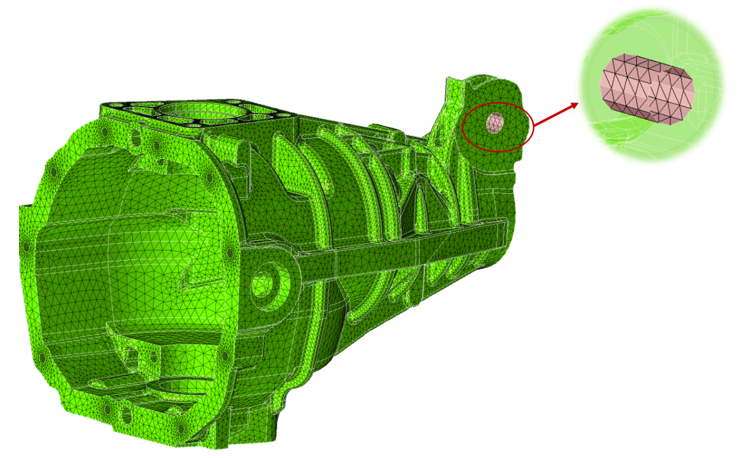

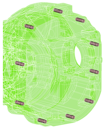

Create Solid Bolds for Assembly

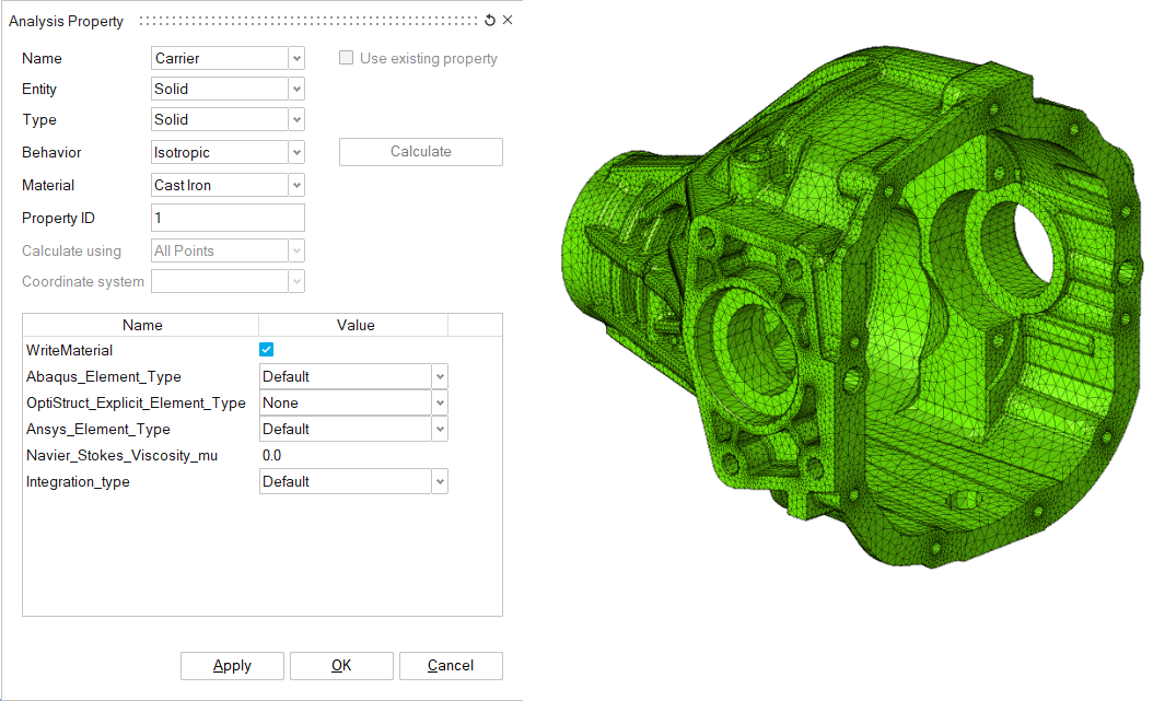

Assign Property to Bodies
In this step you will assign the Cast Iron property for both the Carrier and Cover bodies and Steel property for the Bolts.
SimLab has default materials defined, so there is no need to define materials.

Create Pretension Load

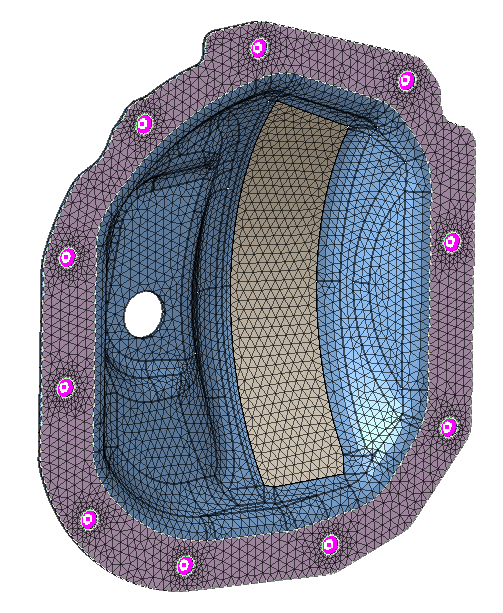

Create Face Group for Pressure Load
Multiple faces must be selected to create a pressure load on the inner face of the cover body.
Create Pressure Load

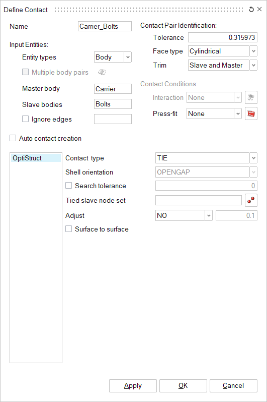

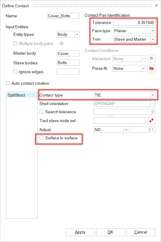

Create Contacts
