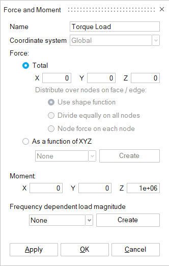

Set Up Loads and Constraints
Define Torque Load
