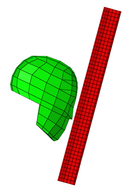

Exercise 2: Define Boundary Conditions and Loads for the Head and A-Pillar Impact Analysis
In this exercise, you will define LS-DYNA boundary conditions, loads, and contacts in HyperMesh. Also, you will set up the boundary conditions and load data for a LS-DYNA analysis of a hybrid III dummy head impacting an A-pillar.

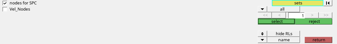

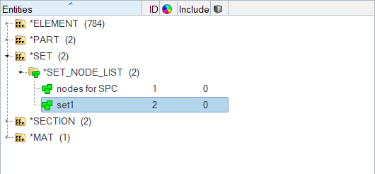

Create a Node Set
In this step, you will create a node set, *SET_NODE_LIST, which will contain all of the nodes in the head component of the model.

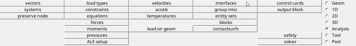

Create a Load Collector
In this step, you will create a load collector for the constraints to be created.
Create Constraints on the Pillar's End Nodes
In this step, you will create constraints on the ends of the pillar component of the model.

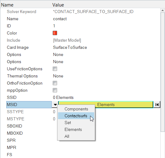

Create a HyperMesh Group
In this step, you will create a HyperMesh group with the SurfaceToSurface card image.
Add the Slave and Master Contactsurfs to the HyperMesh Group
In this step, you will add the slave and master contactsurfs to the HyperMesh group.
Edit the Group card image
In this step, you will define the automatic option for the group in HyperMesh.

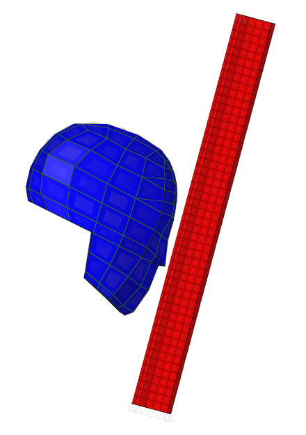

Review the Group Main and Secondary Surfaces
In this step, you will review the main and secondary surfaces for the group.
