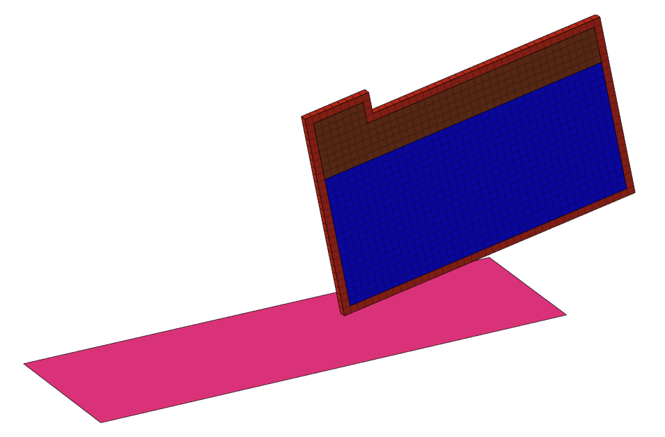

Retrieve and View the Model File
In this step, you will retrieve and view the model file in HyperMesh.

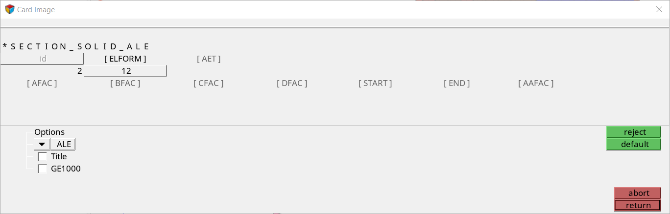

Update the *SECTION_SOLID Card
In this step, you will update the *SECTION_SOLID card used by the ALE components INK and AIR to *SECTION_SOLID_ALE using three methods: Solver Browser, Model Browser, and Card Editor.
Method 1: Use the Solver Browser
Method 2: Use the Model Browser
Method 3: Use the Card Editor

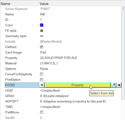

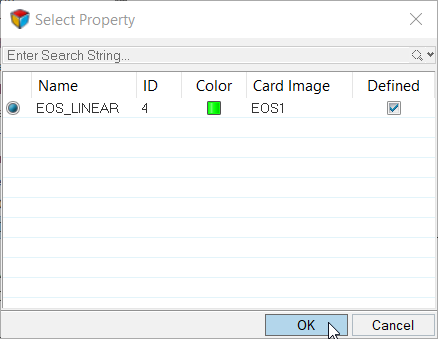

Assign *EOS_LINEAR_POLYNOMIAL
In this step, you will assign *EOS_LINEAR_POLYNOMIAL for the ALE components.

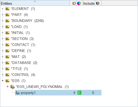

Define *EOS_LINEAR_POLYNOMIAL
For this step, you will define *EOS_LINEAR_POLYNOMIAL for the ALE components.
