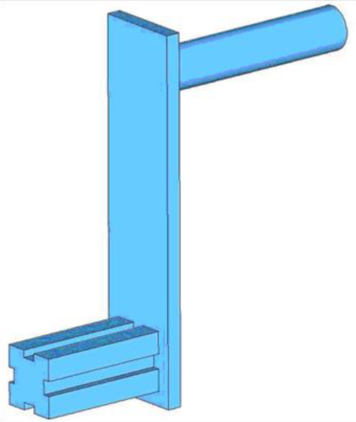

In this tutorial, you will learn how to couple degrees of freedom and to assign a standard beam section using the Section and HyperBeam panels.

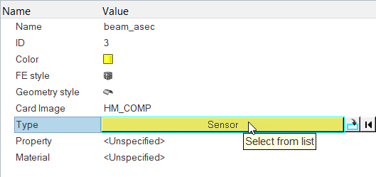

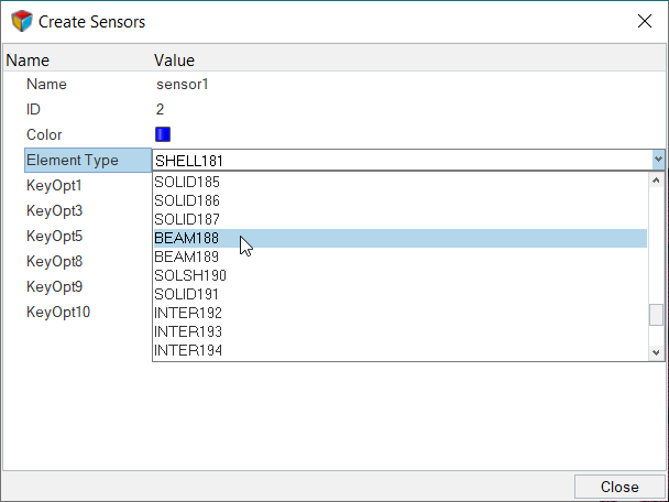

Create Collectors and Attach Element Types and Materials
In this step, you will create collectors and attach element types and materials to the collectors.

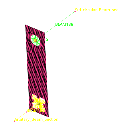

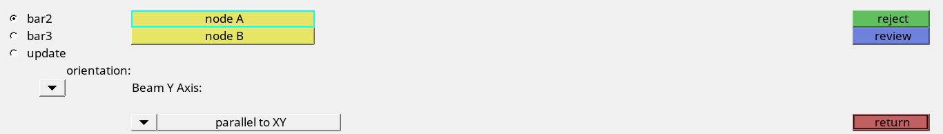

Create a Beam Element
In this step, you will create a Beam element in HyperMesh.
Figure 10.

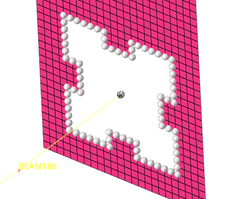

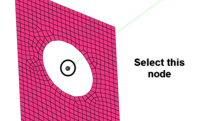

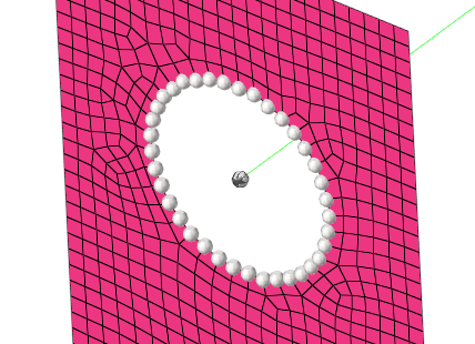

Create Coupled DOF - Rigid Elements
In this step, you will create coupled DOF and rigid elements.
Create and Attach a Standard Circle Property
In this step, you will create and then attach a standard circle property to a component in HyperMesh.

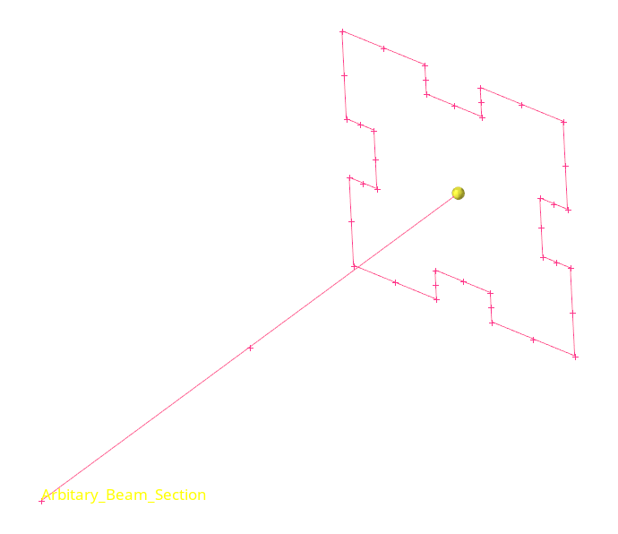

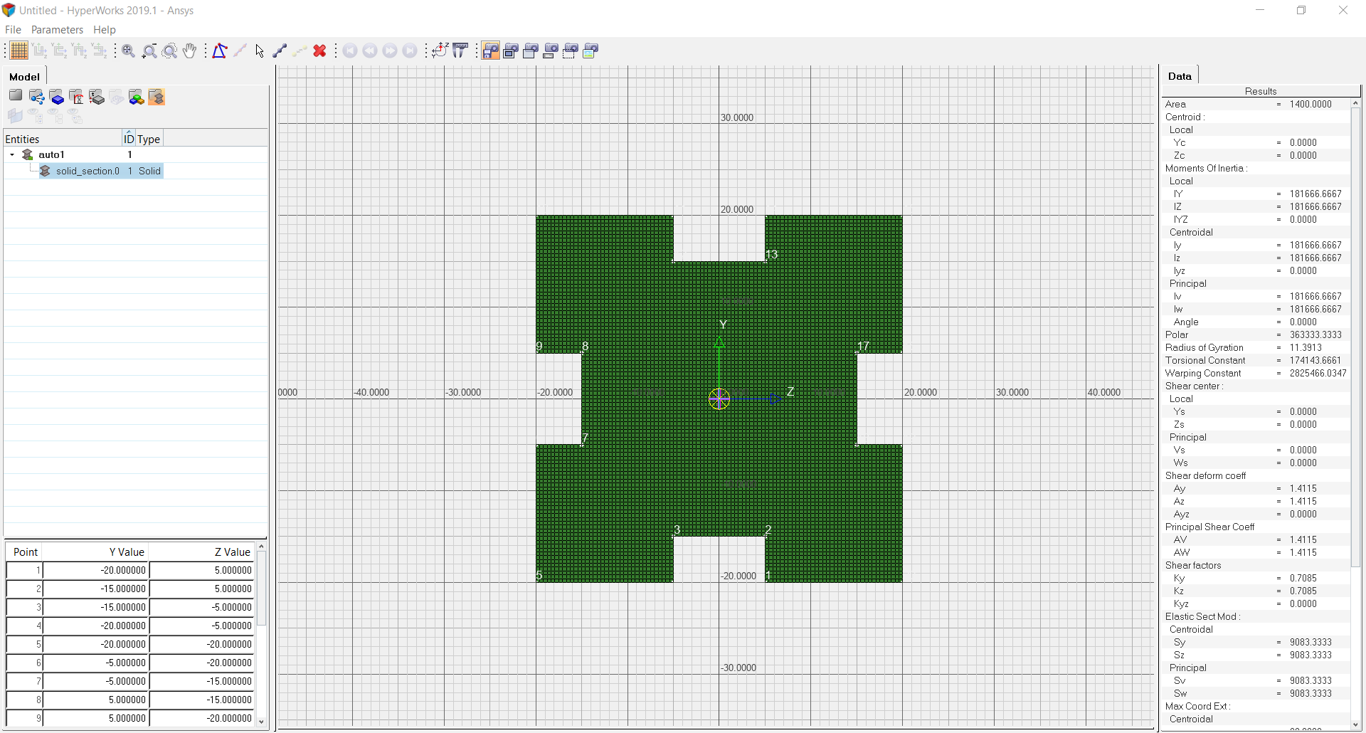

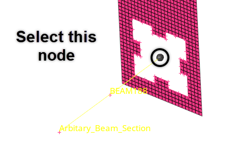

Create an Arbitrary Property
In this step, you will create an arbitrary property in HyperMesh.
Update the Component Collector with the Beam Section
In this step, you will update the component collector with the beam section.
