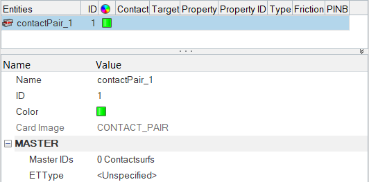

Create a Contact Pair
In this step you will create a contact pair in HyperMesh.

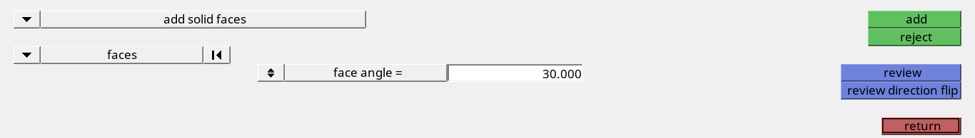

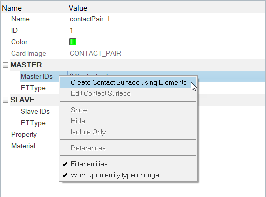

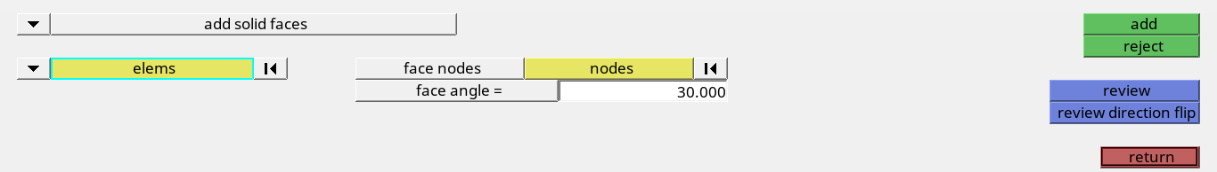

Create and Attach a Contact Surface
In this step you, will create and attach a contact (master) surface in HyperMesh.

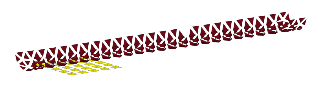

Create and Attach a Target Surface
In this step, you will create and attach a target surface in HyperMesh.

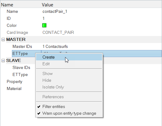

Create and attach a target (secondary) surface.

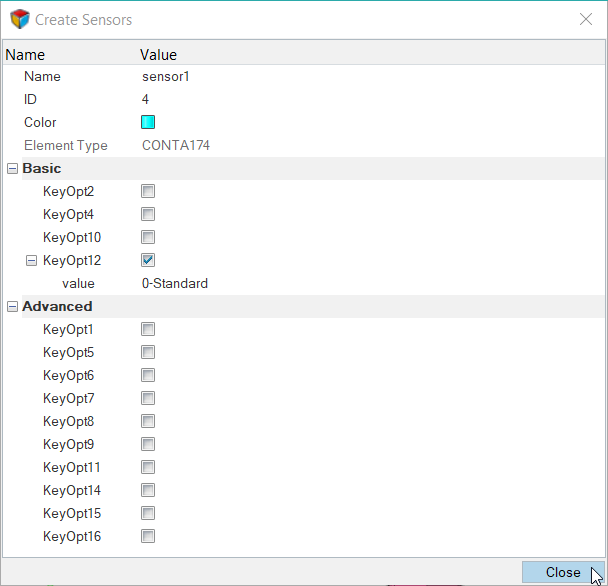

Create and attach an Et Type to the contact surface.

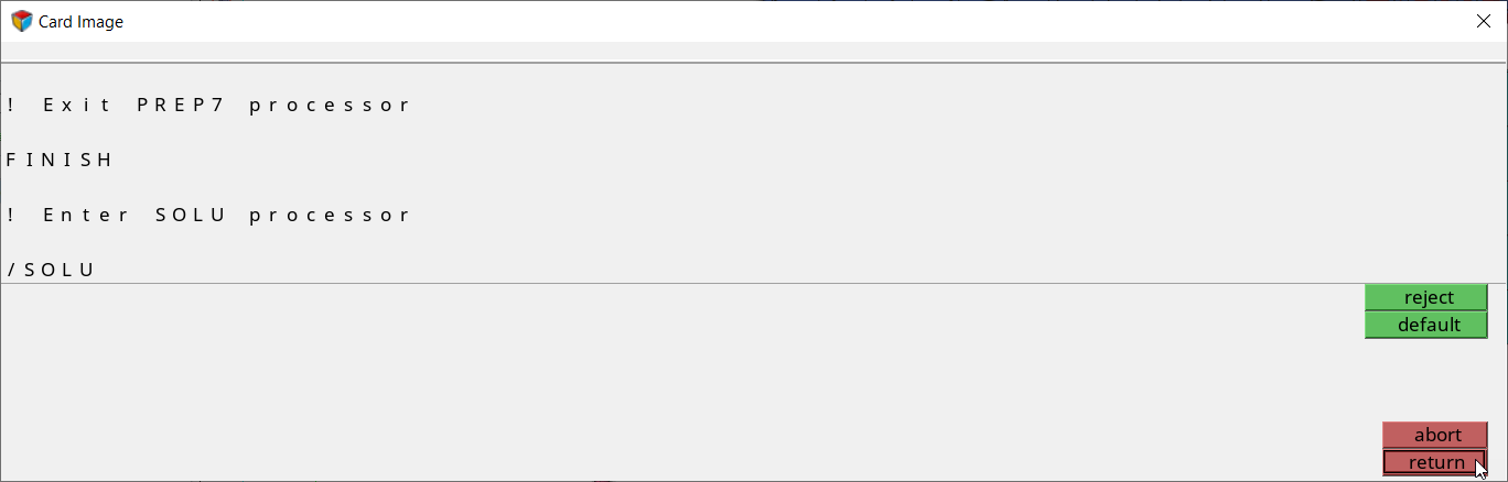

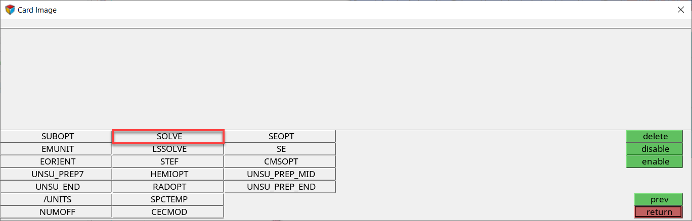

Add /SOLU and SOLVE in the Control Cards
In this step, you will add the following Control Cards.
