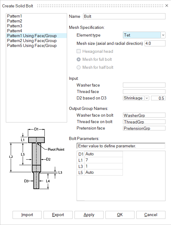

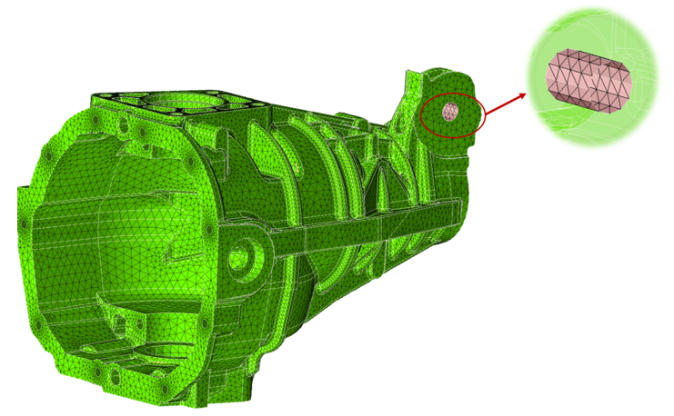

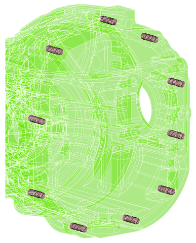

Create Solid Bolds for Assembly

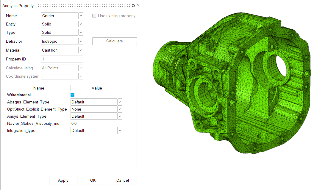

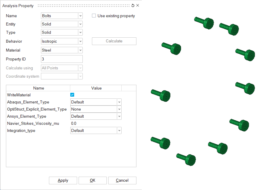

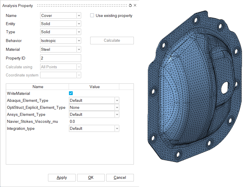

Assign Property to Bodies
In this step you will assign the Cast Iron property for both the Carrier and Cover bodies and Steel property for the Bolts.
SimLab has default materials defined, so there is no need to define materials.

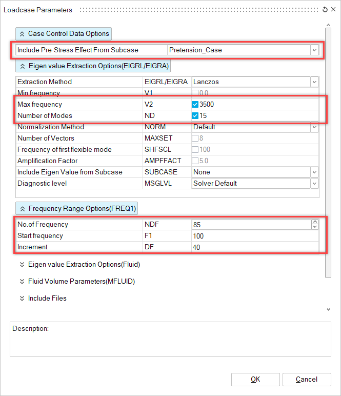

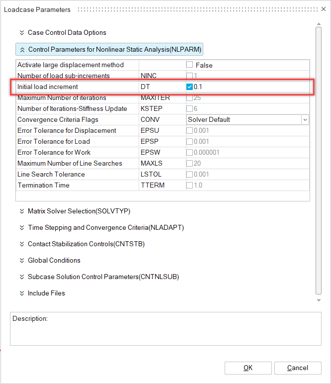

Define Loadcase Parameters
Define Frequency Response Analysis Loadcase

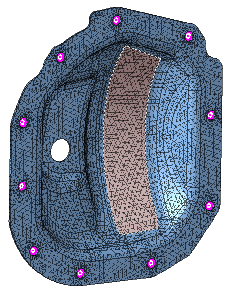

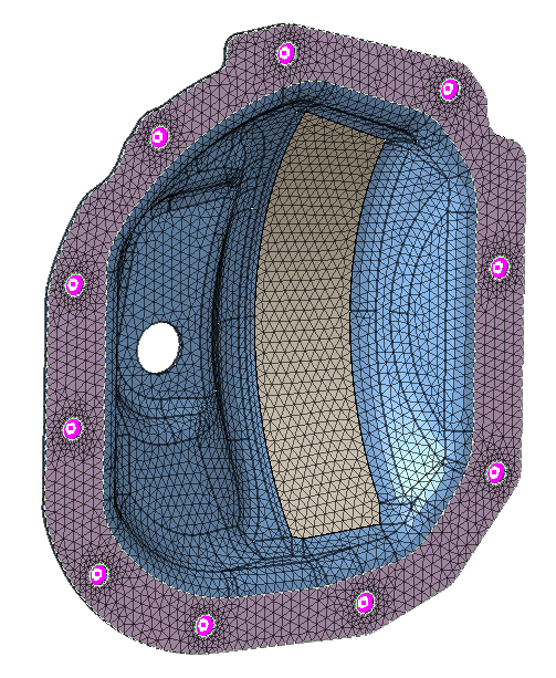

Create Face Group for Pressure Load
Multiple faces must be selected to create a pressure load on the inner face of the cover body.

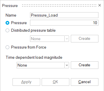

Create Pressure Load

Define Loadcase Parameter and Result Request

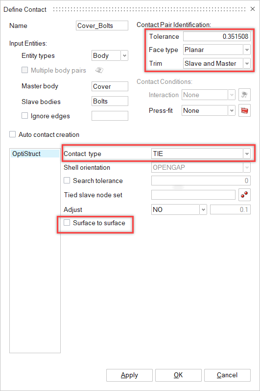

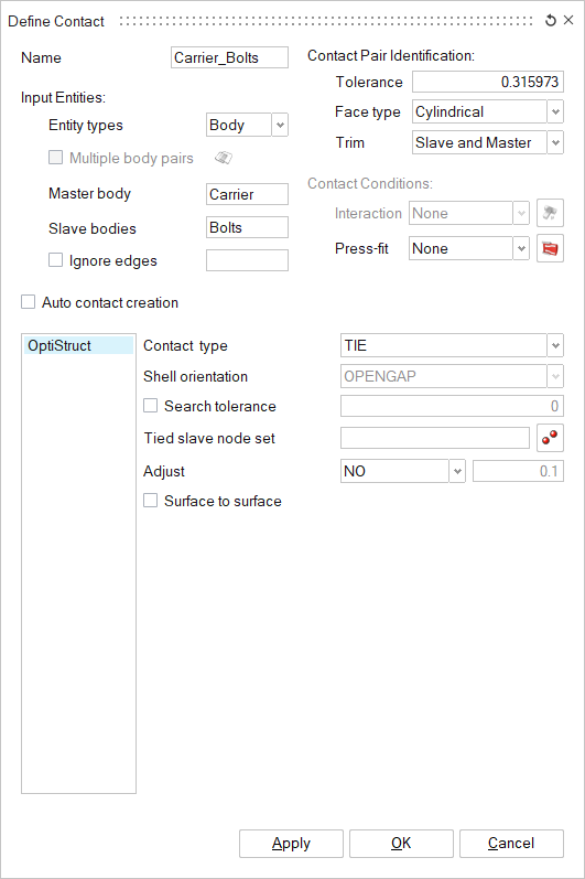

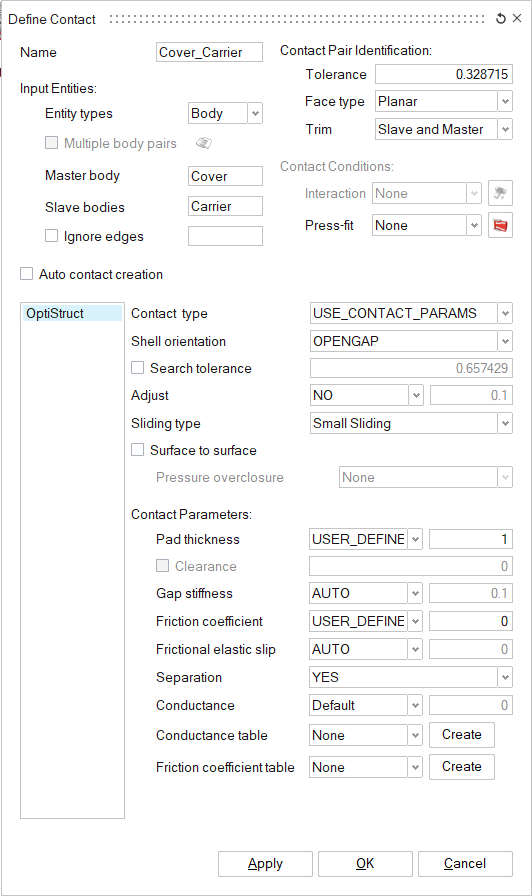

Create Contacts

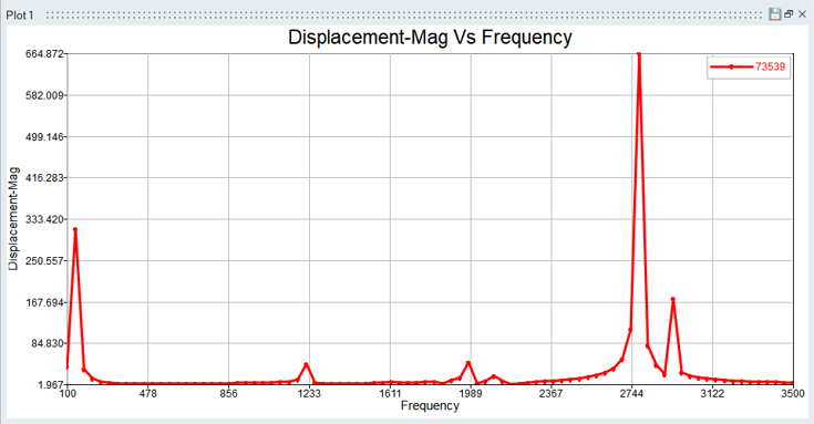

Plot Graph
In this step you will plot a graph of resultant displacement at different frequencies of the Preloaded_MFreq subcase.
