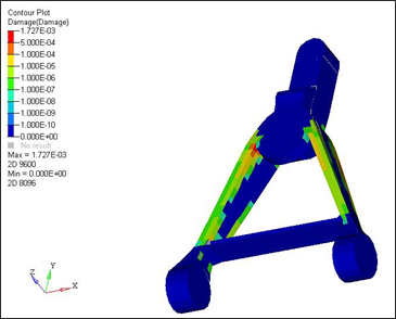

Figure 6. Model of the Control Arm for Fatigue Analysis

The model being used for this exercise is that of a control arm as shown in Figure 1. Loads and boundary conditions and two static loadcases have already been defined on this model.
