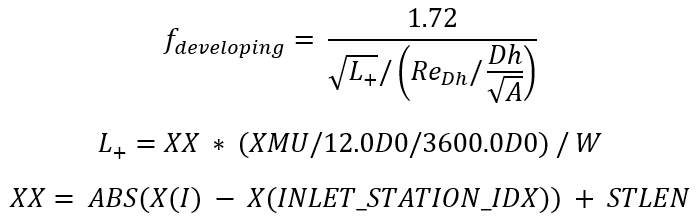

For Tube Element, Laminar Friction Inlets effects can be accounted. Friction coefficient for hydrodynamically developing flow with “Muzychka Yovanovich Laminar Inlet Effects” can be calculated as,

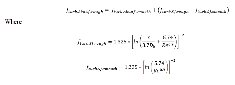

Abuaf Friction Relation
The Abuaf friction relation should generally be used for smooth walled tubes.
Flow Simulator allows users to an option use the Abuaf friction relation together with wall roughness. The following adjustment equation is used:

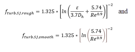

Swamee-Jain approximation of the Colebrook-White equation (Moody diagram)
The Darcy and Fanning type frictions are calculated as:
