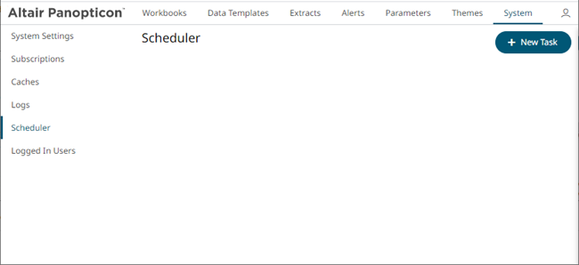

On the Scheduler tab of the System Settings page, Panopticon Visualization Server allows scheduling of tasks.
Cilck New Task . The New Task pane displays that allows you to define the following tasks:
