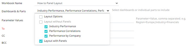

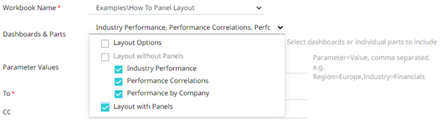

·         Select the Workbook Name in the drop-down list. These are the published workbooks available in the Workbooks page.
·         Select the dashboards and parts to include in the HTML formatted data file by checking their corresponding boxes in the Dashboards & Parts drop-down list.

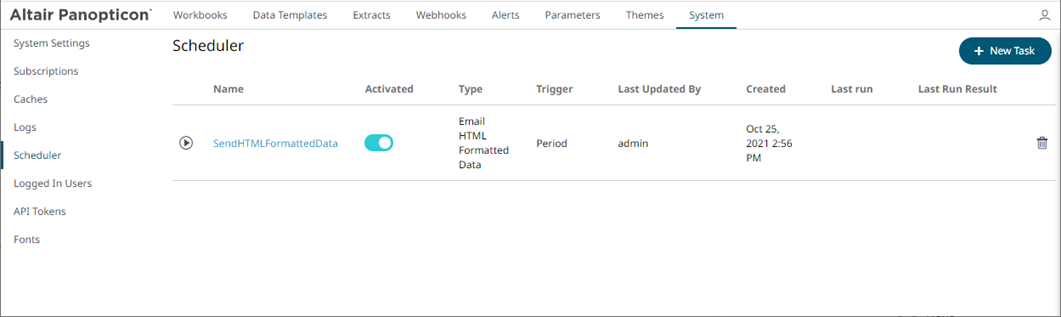

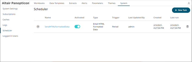

9.     Click .
Click  to go back to the Tasks pane. The new task is added in the list.
