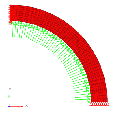

Quad4 Plane Strain elements are used to model the quarter symmetric slice of the pressure vessel of radius 0.1m and thickness 0.020m. Internal pressure of 10,000 Pa which is converted to force and applied on the nodes of the inner surface of the pressure vessel. A Linear Static analysis is performed on this model.
- Young's Modulus
- 207 x 109 Pa
- Poisson's Ratio
- 0.27

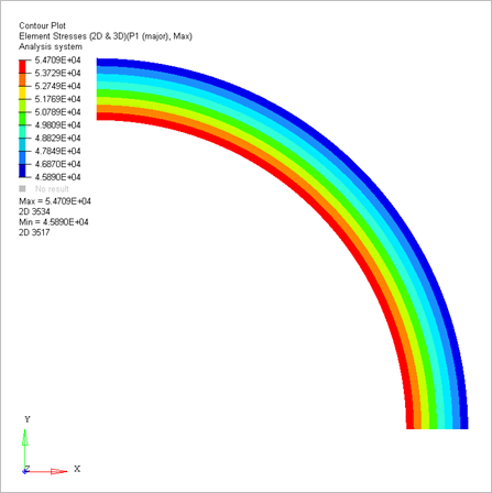

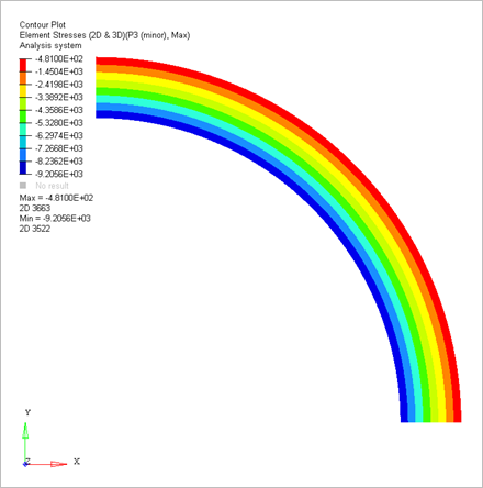

| Model | Hoop Stress (Pa) |
Radial
Stress (Pa) |
| Theoretical | 55455 | -10000 |
| OptiStruct | 54710 | -9205.6 |
| Normalized | 1.013 | 1.086 |
図 2. First Principle Stress (Hoop Stress)
図 3. Third Principle Stress (Radial Stress)
