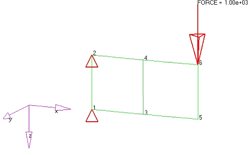

図 1. Sample Model used to Demonstrate Grid Point Force Calculations. This model consists of two elements, a fixed support on the left end, and a point load on the right end.

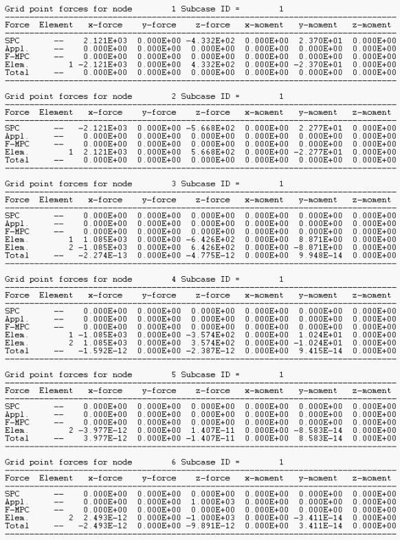

The complete GPFORCE table for the above cantilever beam model is presented below.
注: For any given node within the GPFORCE table, several types of entries are possible depending on the forces acting at that node.
  • Applied forces and moments
  • SPC forces and moments
  • MPC forces and moments
  • Element forces and moments from elements attached to the node
  • Total summed values for each node, which in turn must sum to zero for the complete GPFORCE table.

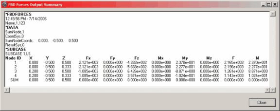

Additionally, the cross-product of all the forces about the Y axis need to be considered. Selecting node 1 as the summation node (any node in the model can be selected) and performing rXF (all element edge lengths are 0.166) the following is obtained:
Node 1
No additional rXF contributions since it is the sum point
Node 2
-0.166*Fx + 0*Fz = -0.166*-2.121e+03 + 0*-2.121e+03 = 3.535e+02
Node 3
0*Fx + -0.166*Fz = 0*-1.085e+03 + -0.166*6.426e+02 = -1.071e+02
Node 4
-0.166*Fx + -0.166*Fz = -0.166*1.085e+03 + -0.166*3.547e+02 = -2.400e+02
These values sum to about 0.

図 3. Output Table from the FBD Forces Utility. Element 1 (element set) with node 1 used as the summation point.

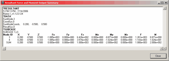

Additionally, the cross-product of all the forces about the Y axis need to be considered. Selecting node 3 as the summation node (any node in the model can be selected) and performing rXF (all element edge lengths are 0.166) the following is obtained:
Node 3
Node 4
-0.166*Fx + 0*Fz = -0.166*1.085e+03 + 0*3.547e+02 = -1.808e+02
These values sum to -2.000e+02. Since there are only four significant digits in the GPFORCE table, the precision of the calculated moments are compromised. In the actual FBD utilities, the full result and machine precisions are used.

図 4. Output Table from the Resultant Force and Moment Utility. For element 1 (element set) and nodes 3 and 4 (node set) with node 3 used as the summation point.
