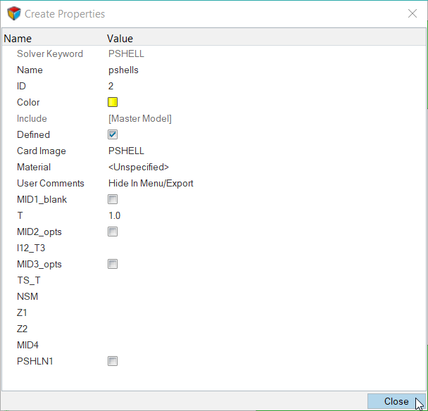

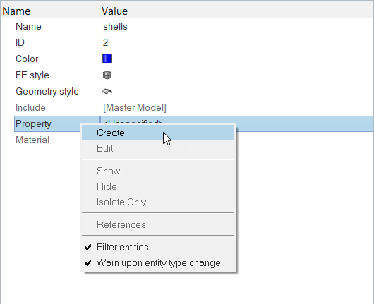

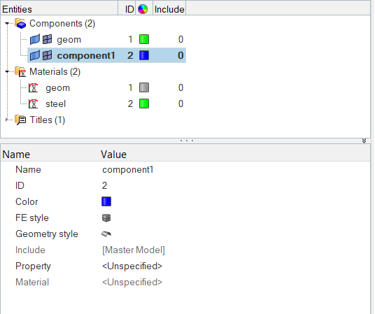

Create Material Collectors and Components
In this step, you will create material collectors and components in HyperMesh.

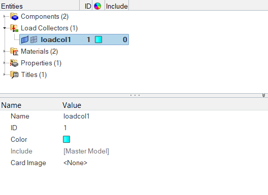

Apply Boundary Conditions to the Model
In this step, you will create collectors, constraints, and forces in order to apply boundary conditions to the model.

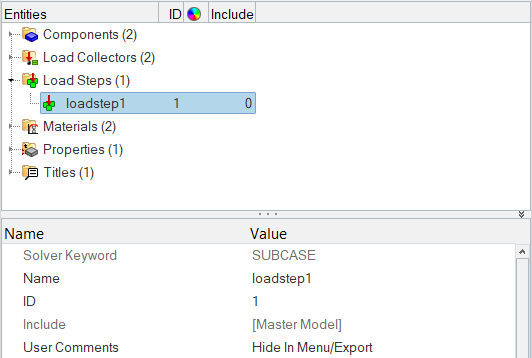

Create a Nastran Subcase
In this step, you will creat a Nastran subcase (a load step in HyperMesh).
Create the load step.
Create control cards.

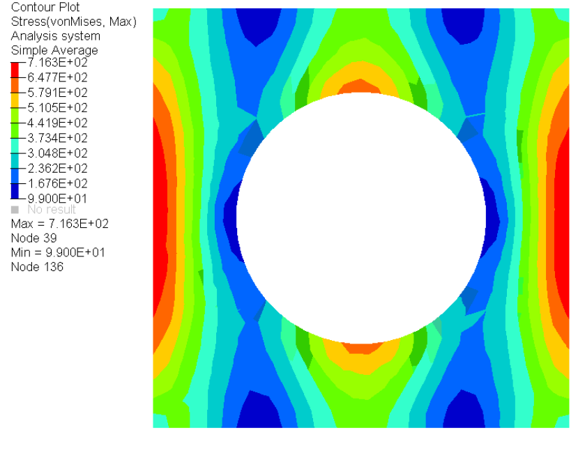

View a deformed shape.
View a contour plot of stresses and displacements.
