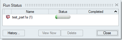

  1. Hover over the Analyze icon, then click Run Status.
    The run status is displayed.

  3. View one or more runs.
    • To view a run, double-click the row.
    • To view multiple runs, hold down Ctrl or Shift while clicking the rows, and then click the View Now button.
      Note: If several runs are associated with the same part, the result from the most recently completed run for that part will be activated in the modeling window.
    • To view deleted or previously viewed runs, click the History button.
Tip: To open the directory where a run is stored, right-click the run name and select Open Run Folder.
