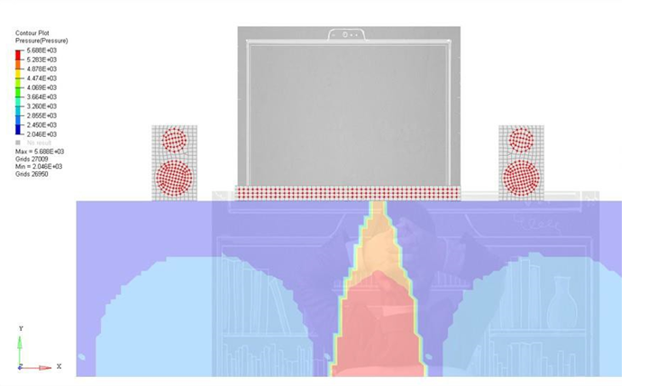

Figure 1. FE Model with Infinite element, Sound source, Acoustic elements and Receiver. Model A

This example has a source plate (green in color) inside the speaker which is vibrating (unit displacement is applied as excitation) along the z-axis. The Source plates are then covered with acoustic fluid elements (front, back and top) as seen in Figure 1. Then the infinite elements are the skin of the front fluid elements whose normal must be pointing towards the receiver as shown, each speaker with IE will have their own pole (which is the center of the source) location. For pressure (as calculated on grids) contour, the receiver elements are configured with PLOTEL elements with fluid grids since you will be capturing the sound pressure on these elements. A direct frequency response analysis is run.

Figure 2. Displacement plots
Figure 3. Pressure plots
As you observer from the contour plot, the acoustic pressure is concentrated in the center along with the imprint of the left and right speaker, hence this does not capture the interaction of the 3 source speaker correctly due to incorrect modeling.

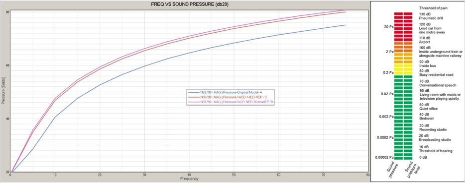

Figure 5. Results Pressure Contour Comparing all 3 Models
Figure 6. Variation of Pressure (db20) over Frequency for all 3 Models
