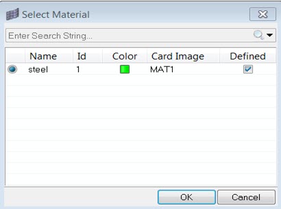

Create the Properties

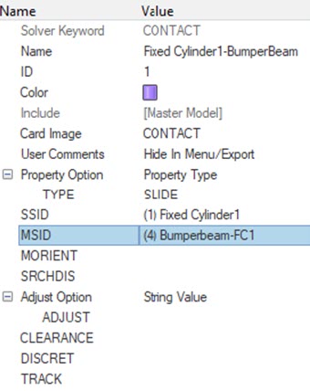

Create Contact Groups
Here the contact groups will be defined.

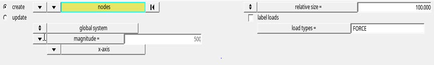

Create Force Load Collector
This step will outline how to apply the force.

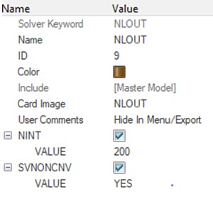

Create NLOUT Load Collector

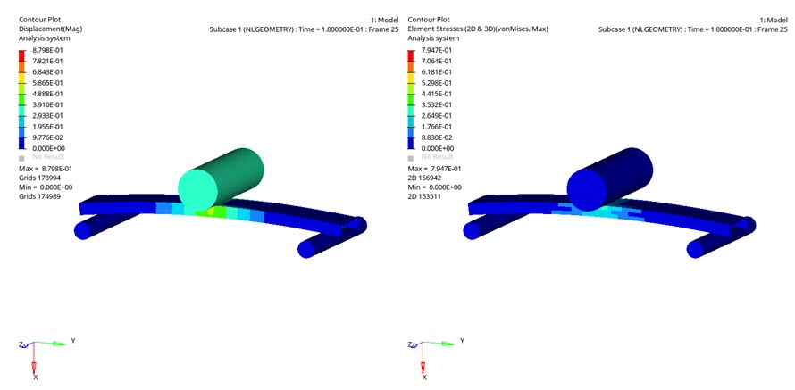

below TABLED1_NUM
and enter the values:
(Contour).
