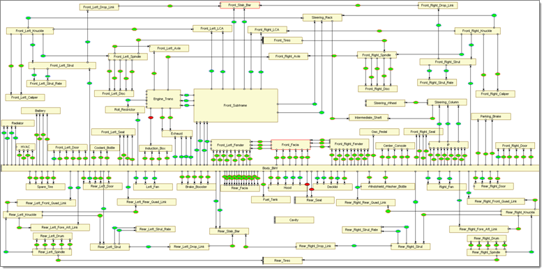

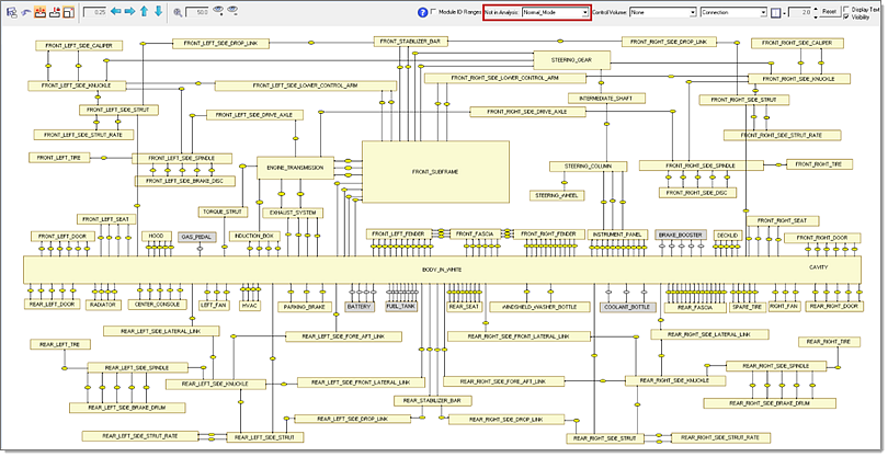

When invoking the network view for the first time, an auto generated block diagram is displayed, which is not likely satisfying. After some effort in organizing the modules and connections, the block diagram can be organized in an easy to view form. The organized view can then be saved in the assembly .xml file so that the organized view will be available when the .xml file is imported.

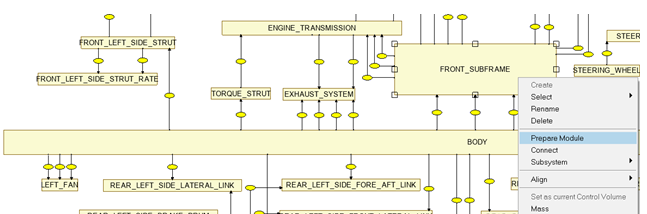

Figure 4. - Make the body box wider. Block the select half of the modules by dragging the left mouse cursor and then move the selected modules up to make room. Click the body's left and right edge and then drag to enlarge the horizontal size.
- Arrange the modules connected to the body above and below the box first and then sequentially arrange the remaining modules based on their connectivity.
