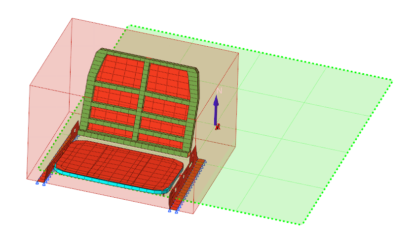

Exercise 1: Define Model Data for the Seat Impact Analysis
In this exercise, you will define and review model data for a LS-DYNA analysis of a vehicle seat impacting a rigid block. The seat and block model is shown in Figure 1.

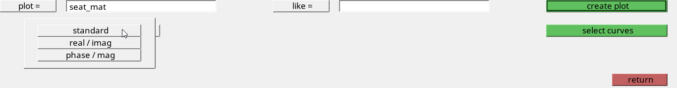

Create an XY Plot
In this step, you will create an XY plot.

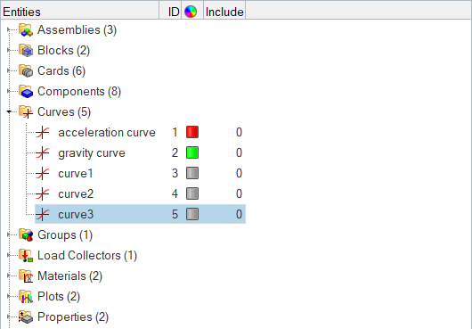

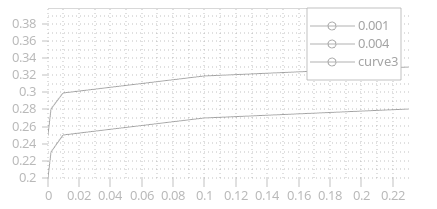

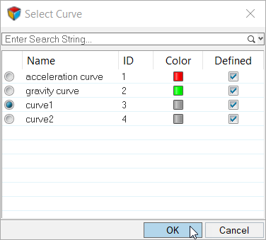

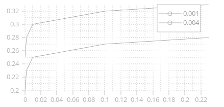

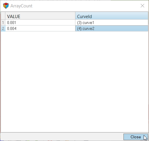

Create Two Stress-Strain Curves
In this step, you will input data from a file to create two stress-strain curves.

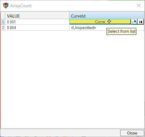

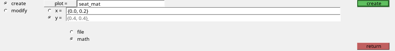

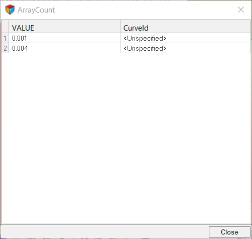

Create a Dummy XY Curve
In this step, you will create a dummy XY curve to be used to create a *DEFINE_TABLE.
Create a *DEFINE_TABLE
In this step, you will create a *DEFINE_TABLE from the dummy curve created in Create a Dummy XY Curve.

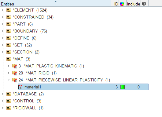

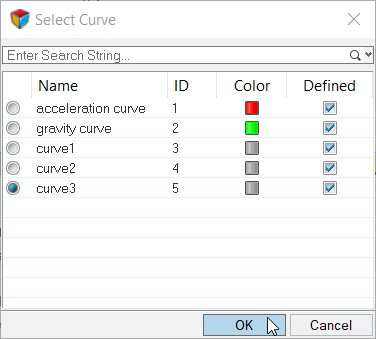

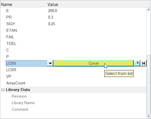

Create a Non-Linear Material
In this step, you will create a non-linear material (*MAT_PIECEWISE_LINEAR_PLASTICITY).

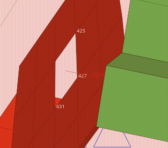

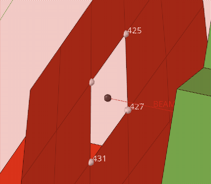

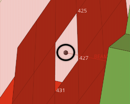

Create a Beam Element
In this step, you will create a beam element, *ELEMENT_BEAM, to complete the seat's back_frame connection to the side_frame on the left side.

Set the current component to beams.
Create the beam element.
Display Node IDs
In this step, you will display node IDs.

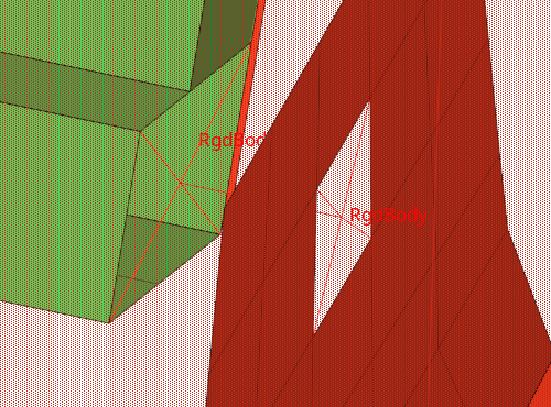

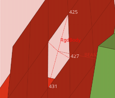

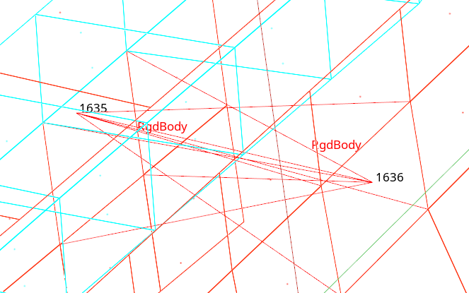

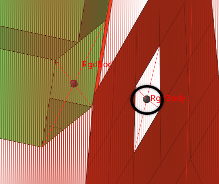

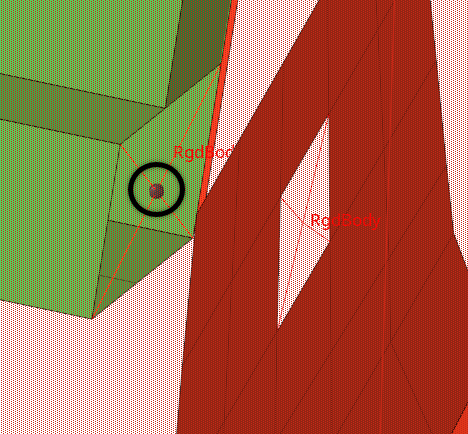

Create the Nodal Rigid Body
In this step, you will create the nodal rigid body (*CONSTRAINED_NODAL_RIGID_BODY).
Display Node IDs
Activate Coincident Picking
In this step, you will activate coincident picking from the graphics panel.
Set the Current Component to Joint
In this step, you will set the joint component as the current collector.

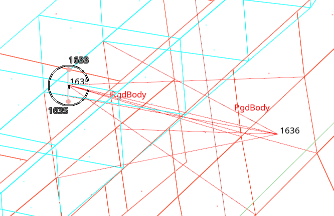

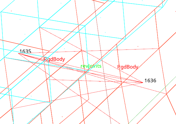

Create a Revolute Joint
In this step, you will create a joint between two nodal rigid bodies (*CONSTRAINED_JOINT_REVOLUTE).

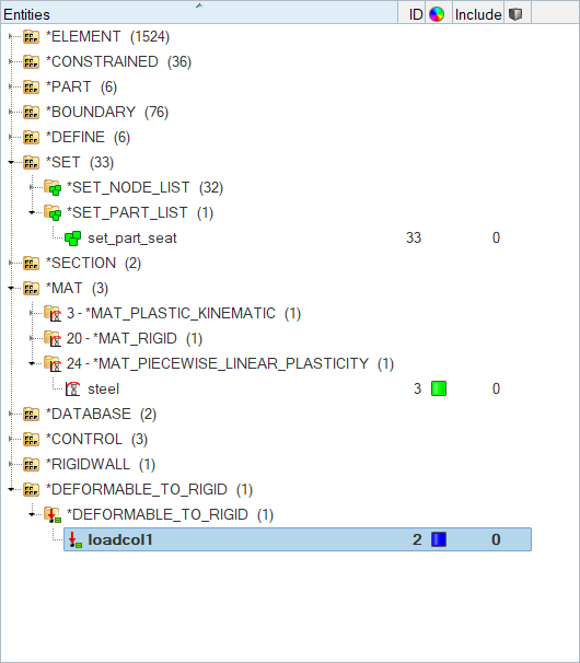

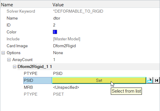

Define *DEFORMABLE_TO_RIGID
In this step, you will define *DEFORMABLE_TO_RIGID to set up the moving seat as rigid until the time of impact with the block, to reduce computation time.

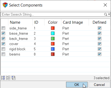

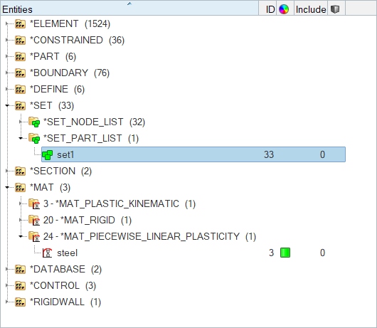

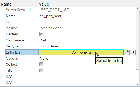

Create an entity set that contains the base_frame, back_frame, and cover
components.
Define *DEFORMABLE_TO_RIGID to switch the deformable seat to rigid at the
beginning of the analysis.

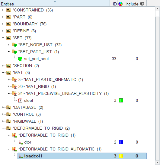

Define *DEFORMABLE_TO_RIGID_AUTOMATIC to switch the rigid seat to deformable
when contact between the seat and block is detected.

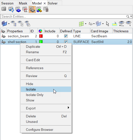

Display only parts of the model with a particular material and section.

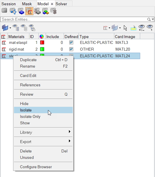

Display only parts with a particular material.
- In the Model Browser, Materials folder, right-click on Steel and select Isolate from the context menu.
- In the Solver Browser, *SECTION folder, select components based on properties.

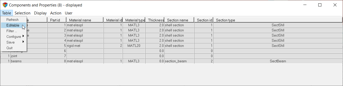

Method 3: Use the Component Table
In this section, you will review the model's component data using the component table.

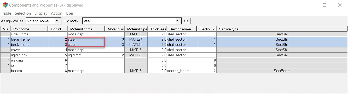

Display all components.
