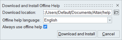

  1. Select File > Help > Download Offline Help.
  2. Choose the download location for the help package. By default, it will be saved and installed in your Documents folder.
  3. Select the offline help language.
    Note: Not all of the languages listed are supported by every product. Also note that translations are generally not available until some time after the initial release date, in which case the previous version of the help will be downloaded instead.
  4. Select Always use offline help if you want to use the locally installed version of the help instead of the online version. You can switch between using the online and offline help in the Preferences.
  5. Click Download and Install. The help package will be downloaded and then installed in the location you specified.

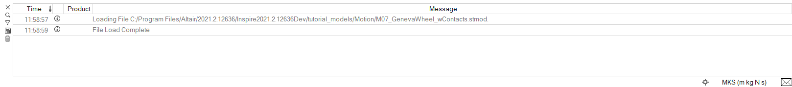

Message Center
View and save messages from Inspire.
  1. In the bottom right corner of the modeling window, select the Message Center icon.
  2. On the left of the Message Center, you will find the option icons.
    • Select the Find and Filter icons to search for messages with specifi criteria.
    • Select a message, and then the Save icon to save it in a text file on your computer.
    • Select a message, and then the Delete icon to remove it from the Message Center.
