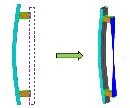

The model used consists of a simplified bumper model:
rd3540_bumper_model
Figure 1. Bumper Model

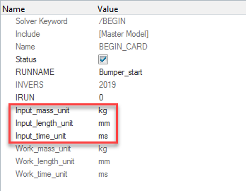

  6. In the Model Browser, verify that the correct units are defined by expanding Cards, BEGIN_CARD.

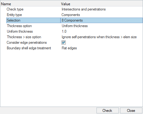

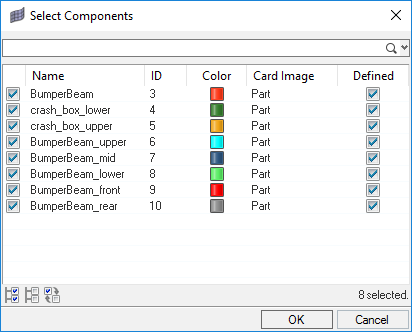

  1. From the Tools menu, select Penetration Check.
  2. Change Entity type to Components.

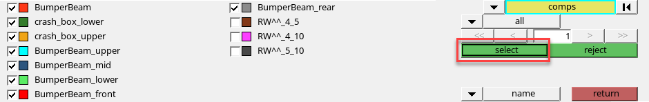

  3. For Selection, click Components, then select the following components and click Close.
  4. For Thicknesss option, select Uniform Thickness and set the Value to 1.0.
  5. Select Consider edge penetration.
  6. Click Check and Close.

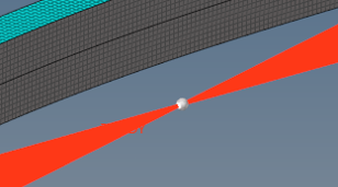

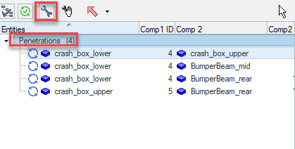

  7. In the Penetrations Browser, click the Review Failed Elements icon .
    Intersections and penetrations will be highlighted.
  8. Click Penetrations, as shown below:
  9. Click the Automatic Intersection/Penetration Fix icon to fix penetrations.

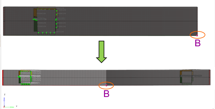

Reflect the Model
  1. From the Tool page, select reflect.
  2. Change the entity selector to elems, then select elems, by collector and select the only the Bumper and Crash collectors, as shown. Click select.
  3. Select elems > duplicate > original comp.
    This will duplicate the element.
  4. Mirror/reflect the model at Y-axis. Select B as the basis point.
  5. Click reflect and return.
  6. From the Tool page, select reflect.
  7. Change the entity selector to connectors, click the connector entity selector and select all. Click again and select duplicate > original connector group.
  8. Reflect/mirror the model at Y-axis. Select B as the basis point.
  9. Click reflect and return to confirm.
  10. From the 1D page, select connectors and spot.
  11. Toggle the realize button and click connectors and select entities using the Shift+left-mouse in the window and draw a box.
  12. Click reflect and return.
    Note: Nodes at the midplane are not yet equivalenced.
  13. From the Tool page, select edges.
  14. Select all elements by a box, whose nodes are at free edges. Change the entity selector to elems amd select all.
  15. Set tolerance to 0.1mm.
  16. Click preview equiv, equivalence and return.

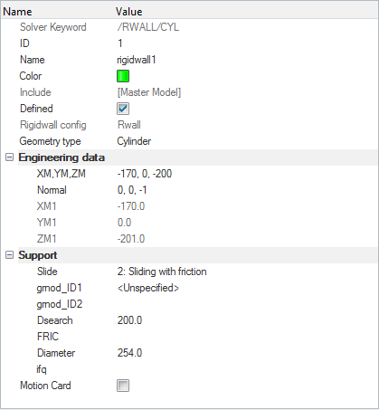

Define the Rigid Wall
  1. Right-click in the Solver Browser and select Create > RWALL > CYL.
  2. For Name, enter RWALL.
  3. For XM, YM, ZM, enter -170, 0, -200, respectively.
  4. For Normal, enter 0, 0, -1, respectively.
  5. For Sliding, select 2: Sliding with friction.
  6. For FRIC, enter 0.2.
  7. For Dsearch, enter 200.0mm.
  8. For Diameter, enter 254.0mm.

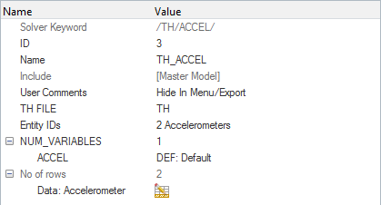

Create Accelerometer for Post-Processing
  1. Right-click in the Solver Browser and select Create > ACCEL.
  2. For name, enterACCELER01.
  3. For Fcut, enter 1.650.
  4. For node_ID, click Node and select the node to the left in Figure 19 .
    Figure 19.
  5. In the Solver Browser, right-click on the previously created accelerometer, ACCELER01 and click Duplicate.
    A new Accelerometer is created.
  6. Click on the new accelerometer and rename to ACCELER02.
  7. For node_ID, click Node and select the node to the right in Figure 19.

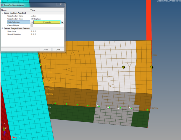

Create a Cross Section
  1. Right-click in the Model Browser and select Create > Cross Section.
    A Cross Section Assistant opens.
  2. For Cross Section Name, enter section.
  3. For Entity Selection, click Components and change to Elements.
  4. Select elements in left crushbox using a window and click proceed.
  5. For Base Node, select the arrow to pick a node that defines the base node.
  6. Select the node on bumper side of the accelerometers and click proceed.
  7. For Normal Direction, click the Select direction arrow to pick a node.
  8. Click N1 to set N1 and N2, as shown, which defines the normal vector and click proceed.
    Figure 22.
  9. Click Create, then click Close.

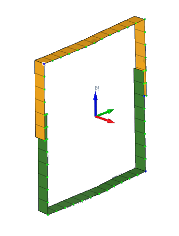

  6. Click beside Entity IDs twice to edit the nodes in the set.
  7. Left-click to select and right-click to deselect nodes until all the nodes selected are in a row, as shown.
    Figure 25.
  8. Click Proceed and close.
    To review the cross section, refer to Review the Cross Section.
Define 2nd Penetration Check
  2. Click Invoke Penetration check setup Widget icon .
  3. For Entity type, select Groups and select all_vers_all contact group.
  4. Click Check.
  5. In the Penetrations Browser, click the Review Failed Elements icon .
  6. Expand the Penetrations folder in the browser and select all_contact to see the elements with the penetrations.
  7. Click Automatic Penetration/Intersection Fix icon to remove penetrations.
  8. Click Recheck icon , if there are any penetrations or intersections.

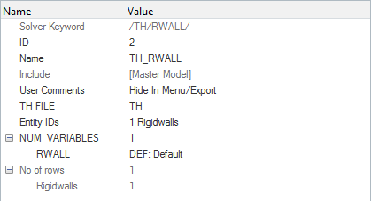

  5. In the Solver Browser and select Create > TH > RWALL.
  6. For Name, enter TH_RWALL.
  7. For Entity IDs, select Rigidwalls and select RWALL and click OK.
  8. For NUM_VARIABLES, select 1.
    Figure 27.
  9. In the Solver Browser and select Create > TH > ACCEL.
  10. For Name, enter TH_ACCELERO.
  11. For Entity IDs, select Accelerometers and select the two ACCELEROS and click OK.
  12. For NUM_VARIABLES, select 1.
    Figure 28.

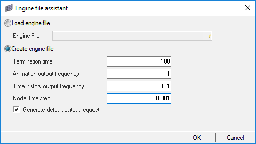

Create Control Cards
  1. To start the Engine file assistant, select Tools > Engine File Assistant.
  2. Input the values, as shown below and click OK.
    Figure 29.

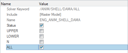

  3. Click Tools > Create Cards > ENGINE KEYWORDS > ANIM > ANIM/SHELL/DAMA to add additional engine control cards.
  4. For ALL, check the box.
    Figure 30.
