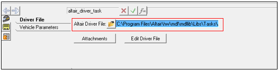

Source the file in the Altair Driver File
browser.
Figure 9.
Note: The Edit driver file button can be used to edit the file.

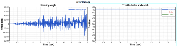

Figure 10.
Select the recent run in the View Reports dialog and click
OK.
Figure 11.
The noise in the steering is numerical error of negligible magnitude – 0 for
all practical purposes. Throttle is constant at 0.5 (driver throttle, brake and
clutch outputs are normalized so, 50%) and brake is constant at 0.
Figure 12.

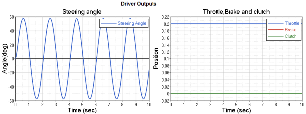

Model an Open Loop Sinusoidal Steering Event
In this step, you will model a simple event with constant 20% throttle, constant 0%
throttle and sinusoidal steering input with amplitude of 60 degrees (∏/3 radians) and
frequency of 0.5 Hz.
Open any text editor and copy and paste the following text into it.
Important: All blank lines must be removed prior to saving the
file.

BRAKE OL_BRAKE NONE
$---------------------------------------------------------OL_STEER.$SIGNAL_CHANNEL tells the driver which solver variable in Signal Generator to over-ride$with the EXPRESSION value. The EXPRESSION should be consistent with MOTIONSOLVE.[OL_STEER]
TAG = 'OPENLOOP'
TYPE = 'EXPRESSION'
SIGNAL_CHANNEL = 0EXPRESSION = 'DTOR(60)*SIN(2*PI*0.5*TIME)'$---------------------------------------------------------OL_THROTTLE [OL_THROTTLE]
TAG = 'OPENLOOP'
TYPE = 'CONSTANT'
VALUE = 0.2
$---------------------------------------------------------OL_BRAKE[OL_BRAKE]
TAG = 'OPENLOOP'
TYPE = 'CONSTANT'
VALUE = 0.0
Run the simulation and study the results.

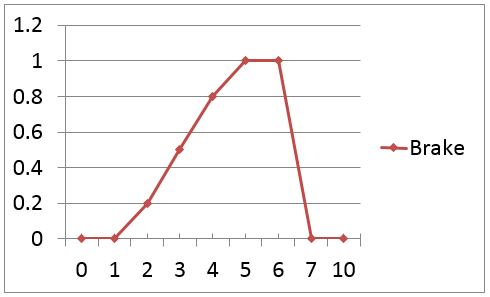

Model an Open Loop Curve Driven Braking Event
In this step, you will model a simple event with braking signal as a
curve.
Figure 15.

$---------------------------------------------------------CURVE_DATA[BRAKE_CRV]
INDEPENDENT_VARIABLE = 'TIME'
DEPENDENT_VARIABLE = 'BRAKE_SIGNAL'
INTERPOLATION = 'LINEAR'
{TIME BRAKE_SIGNAL}
0 0
1 0
2 0.2
3 0.5
4 0.8
5 1.0
6 1.0
7 0
10 0
