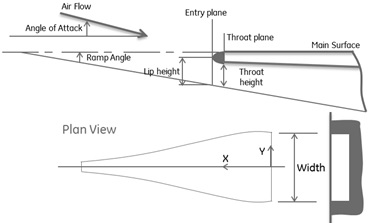

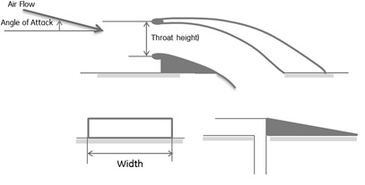

Typical Geometry inputs that are required to model Naca Inlets are provided in the below images
Flush Type:
Scoop type:

| 2 | Nacelle Distance (NACELLE_DIST) | Distance from leading edge of the nacelle to the start of the inlet. |
| 3 |
Throat Height (THROAT_HEIGHT) |
Inlet throat height |
| 4 |
Throat Width (WIDTH) |
Inlet throat width |
| 5 |
Lip Height (LIP_HEIGHT) |
Flush lip height *Used only in ESDU-Flush |
| 6 |
Ramp Angle (RAMP_ANGL) |
Ramp angle *Used only in ESDU-Flush |

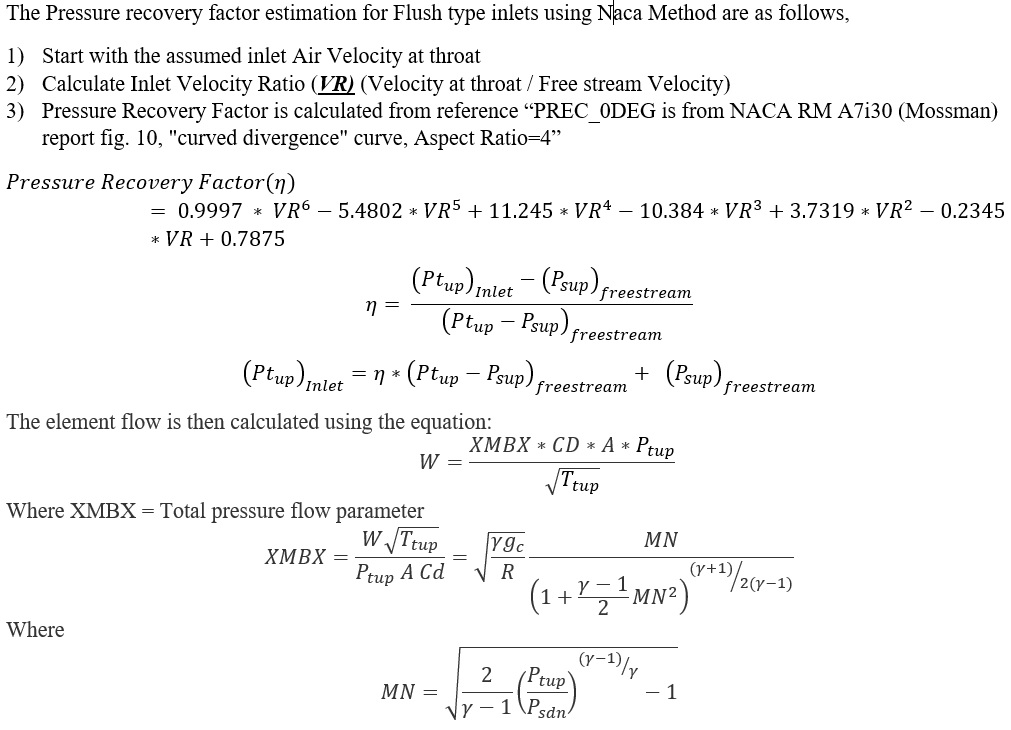

Flush Type Inlets (Naca Method)

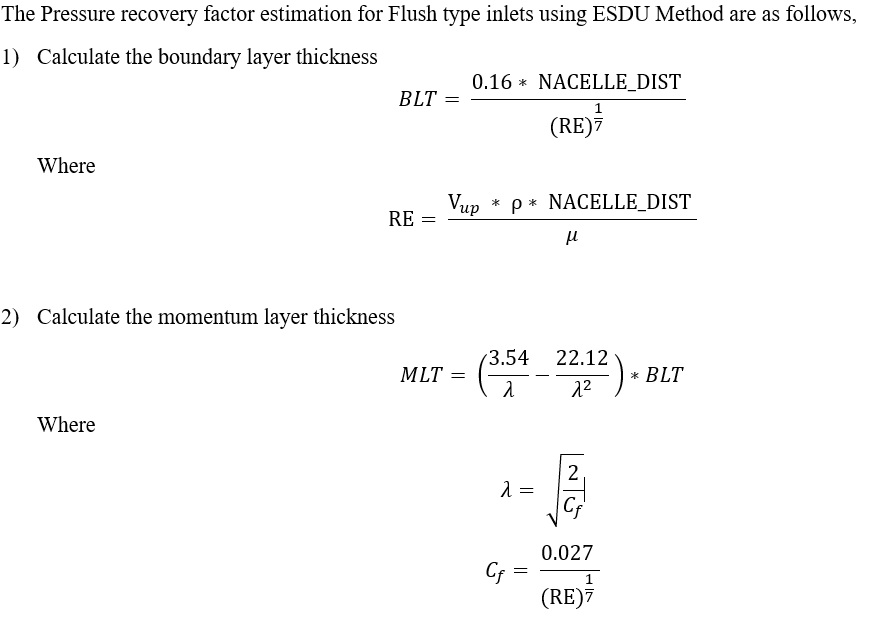

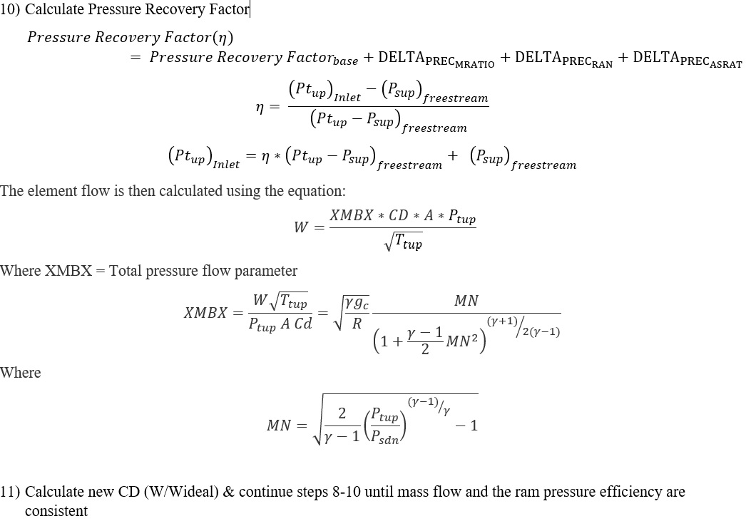

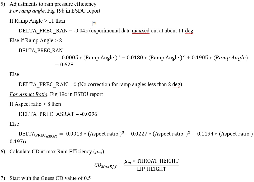

Flush Type Inlets (ESDU Method)

| RAM_P_EFF | Ram Pressure Efficiency (recovery factor) after adjustments (PT1-PS0)/(PT0-PS0). | (unitless) |

| REY | Reynolds Number based on distance from the nacelle leading edge. | (unitless) |
| BND_LAY_THK | Turbulent flat plate boundary layer thickness. | in, m |
| MOM_LAY_THK | Turbulent flat plate momentum layer thickness. | in, m |
| RAMP_ANGLE |
Ramp angle. (Echo of the user input value.) |
deg |
| RAM_P_EFF | Ram Pressure Efficiency after adjustments (PT1-PS0)/(PT0-PS0), ETTA in ESDU paper. | (unitless) |
| BASE_EFF | Ram Pressure Efficiency before adjustments (PT1-PS0)/(PT0-PS0). | (unitless) |
| MFLO_COR | Delta Ram Pressure Efficiency due to the mass flow not equal to full mass flow. | (unitless) |
| RAMP_ANG_COR | Delta Ram Pressure Efficiency due to the ramp angle. | (unitless) |
| ASRAT_COR | Delta Ram Pressure Efficiency due to the aspect ratio. | (unitless) |
