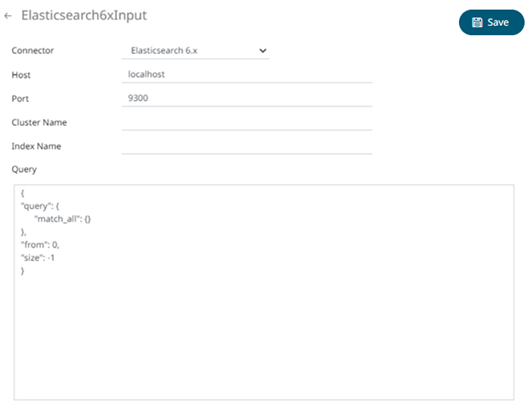

1. In the New Data Source page, select Input > Elasticsearch 6.x in the Connector drop-down list.
2. Enter the following information:
Property |
Description |
Host |
The hostname of any node in your Elasticsearch cluster, or localhost for a node on your local machine. |
Port |
The port running the Elasticsearch HTTP service (default is 9300). If the port you wish to use is different from the default port, change the value to the correct one. |
Cluster Name |
The cluster name that can be used to discover and auto-join nodes. |
Index Name |
The Index name in Elasticsearch. This is some type of data organization mechanism that allows partition of data in a certain way. |
3. Enter an optional JSON-encoded request body in the Query box.
4. Click
. The new data source is added in the
Data Sources panel.
