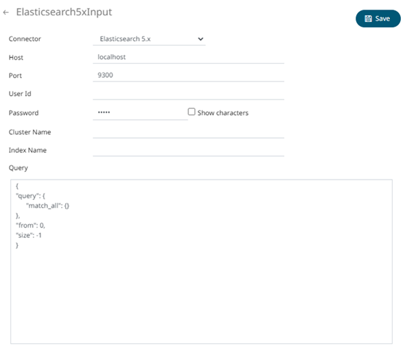

1.     In the New Data Source page, select Input > Elasticsearch 5.x in the Connector drop-down list.
2.     Enter the following information:
Property
Host
The hostname of any node in your Elasticsearch cluster, or localhost for a node on your local machine.
Port
The port running the Elasticsearch HTTP service (default is 9300). If the port you wish to use is different from the default port, change the value to the correct one.
User Id
The username used to connect to the Elasticsearch 5.x service.
Password
The password used to connect to the Elasticsearch 5.x service.
Check the Show Characters box to display the entered password characters.
Cluster Name
The cluster name that can be used to discover and auto-join nodes.
Index Name
The Index name in Elasticsearch. This is some type of data organization mechanism that allows partition of data in a certain way.
3.     Enter an optional JSON-encoded request body in the Query box.
4.     Click . The new data source is added in the Data Sources panel.
