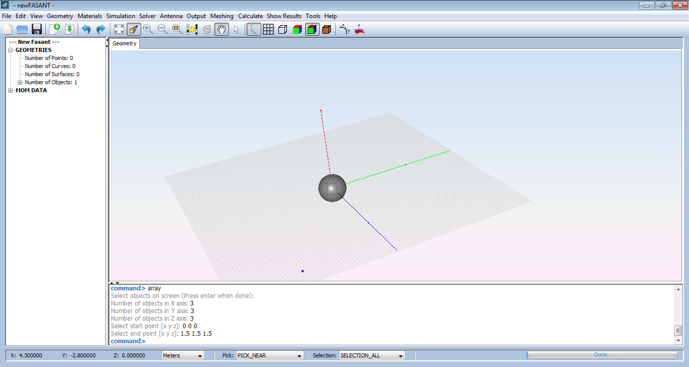

First, create any geometry (for example a sphere). To create it, click on “Geometry”, “Solids”, and click on “Sphere”. Now click on “Edit”, “Geometric Operations”, and click on “Array”.
This option is used to double up the selected surface. To do this, enter the number of copies in X, Y and Z and the distance between them using a starting point and end point.
For example, create a rectangle and press the option array. Then select the desired surface as shown in the next Figure.
![](../../../../../../images/newfasant/gui/edit_menu/geometric_operations/arrays/12.png)
Figure 1. Selecting the sphere to replicate

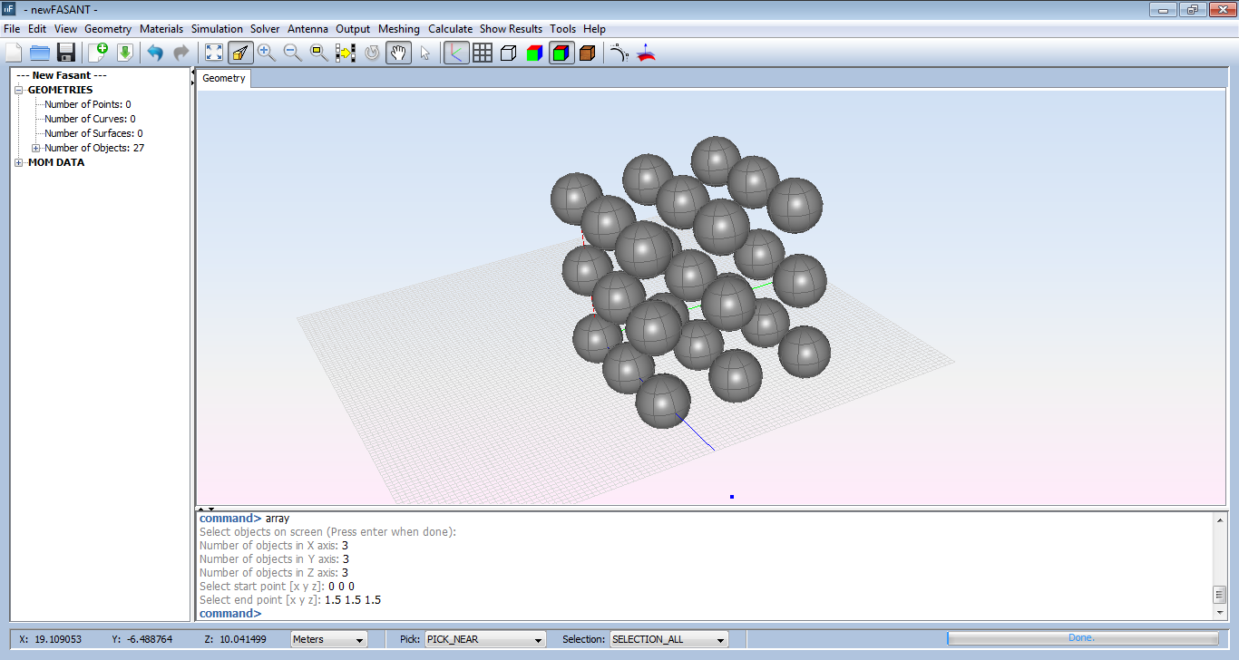

Then introduce the parameters shown in the command line of the figure below and press enter. The results are seen in the next Figure.
![](../../../../../../images/newfasant/gui/edit_menu/geometric_operations/arrays/13.png)
Figure 2. After applying the array function
