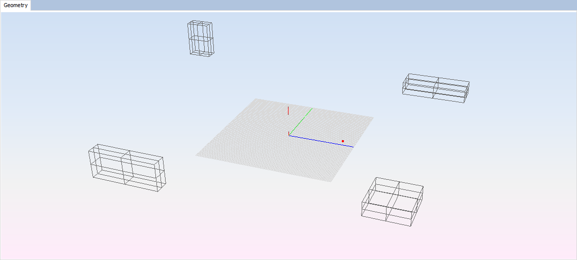

Step 2: Build the geometries. For this purpose the user can use all options available to construct geometries (see Geometry Menu). Generate a plane typing 'plane' on the command line panel, and introducing the following parameters when the command line ask for it:
- First corner of base [x y z] 6.0 10.0 0.0
- Box size [width depth] 5.0 2.0
- Height 1.0
Repeat the operation with the following parameters:
- First corner of base [x y z] -15.0 12.0 0.0
- Box size [width depth] 2.0 1.0
- Height 3.0
- First corner of base [x y z] 8.0 -8.0 0.0
- Box size [width depth] 3.0 3.0
- Height 1.0
- First corner of base [x y z] -10.0 -10.0 0.0
- Box size [width depth] 5.0 1.0
- Height 2.0
The following figure shows the created boxes:

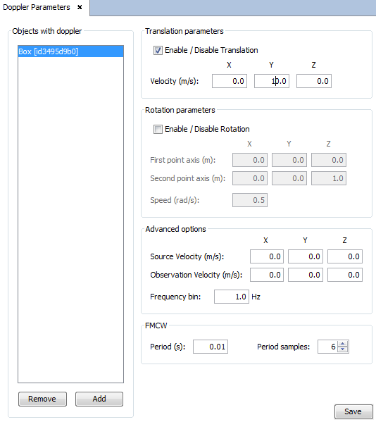

Step 4: Set the doppler parameters using "Simulation --> Doppler" option on the menu bar. With this option doppler effect will be added for the desired objects. Add the object selected in the next figure, selecting it and clicking on the “Add” button of the “Objects with doppler” panel.
Then set the parameters as the next figure shows, to add to the object a velocity of 10 m/s on the Y-Axis. Select "Enable/Disable FMCW" to obtain the analysis of 6 period of time with 0.01 seconds of duration. Then we analyze 6 periods of time with the movements on the object calculating the position of each moment with the duration of a period and the velocity.

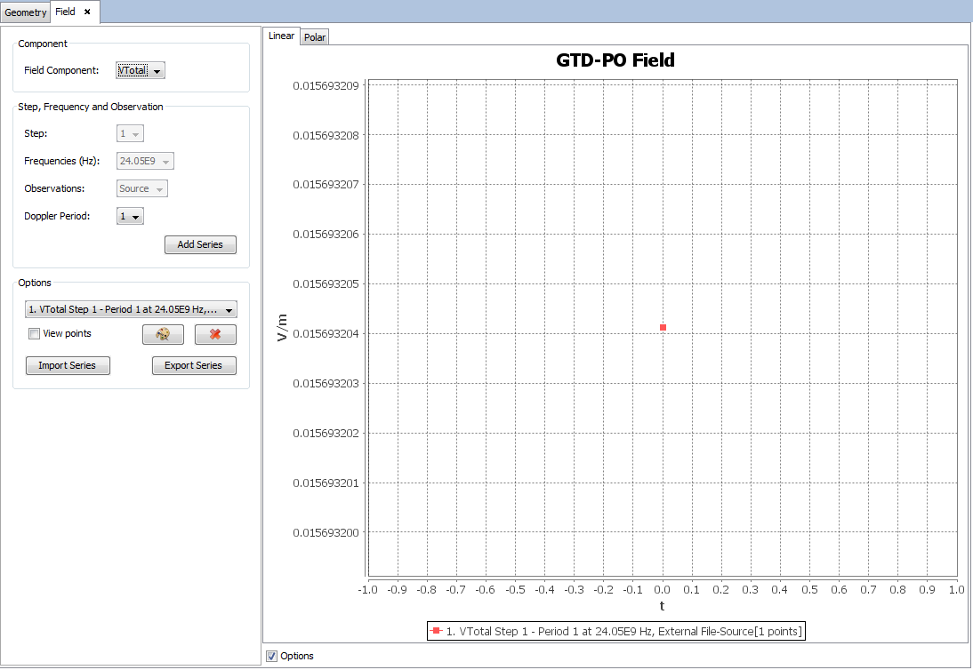

Step 8: Display the information about the field value with "Show Results --> Field --> View Cuts". The representation indicates the field component value on the observation point, in the case, the same point of the source, for a step, a frequency and period.
Selecting other field component, step, frequency or period and clicking on “Add Series” button adds other visualization of field.

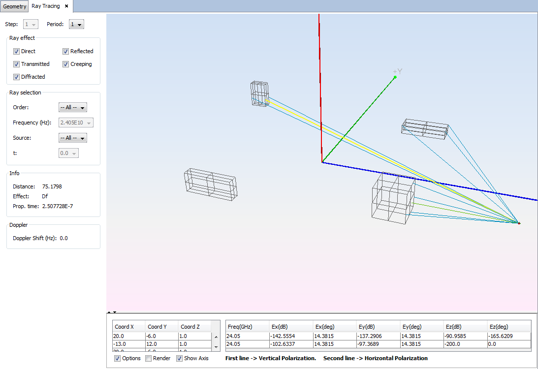

Step 9: Display the information about the ray tracing with "Show Results --> Ray Tracing --> View Ray". The representation shows the rays for the selected step, period, frequency and source position. The rays can be filtered by effects and orders.
Selecting other step, frequency, period, position of the source or the orders and effects the visualization will be updated printing the rays that have the selected parameters. Selecting a ray into the panel, the information about it will be displayed on the tables at the bottom of the panel and on the ‘Info’ and ‘Doppler’ panels on the left panel.

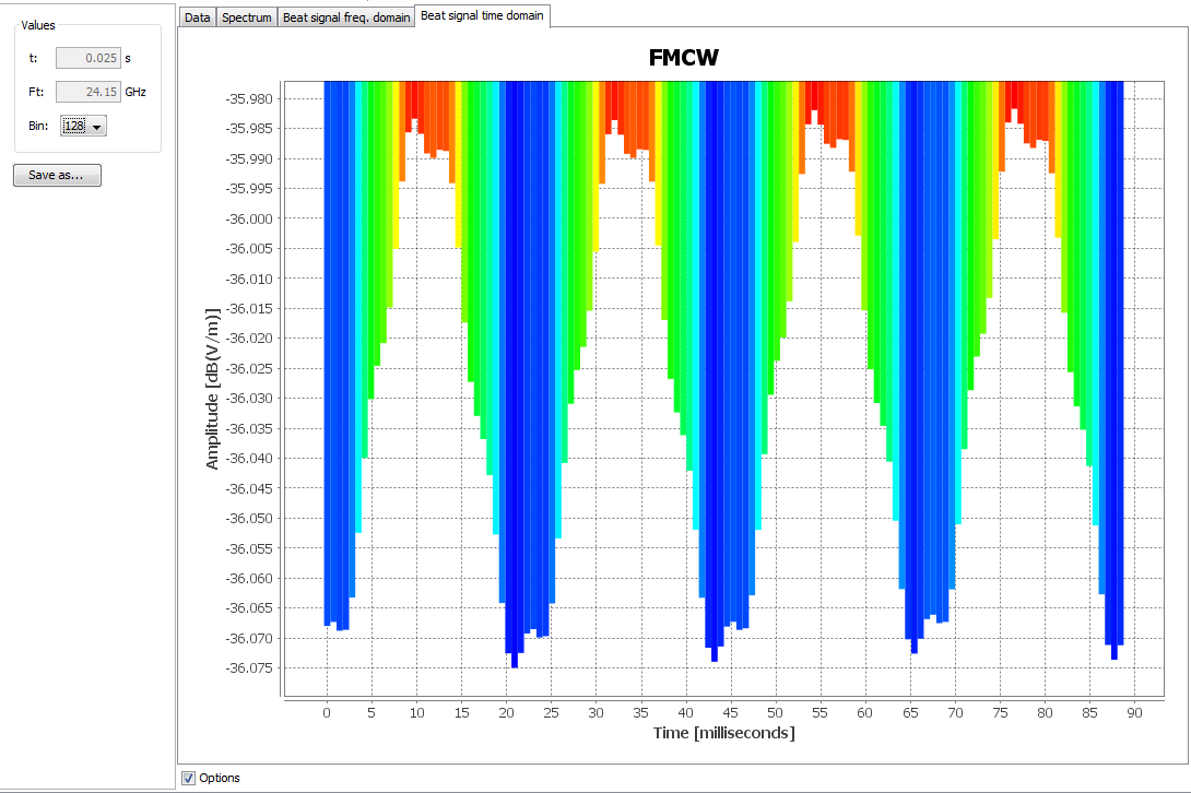

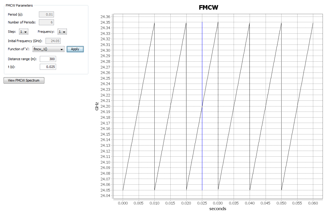

Step 10: Display the information about the FMCW spectrum with "Show Results --> Doppler --> FMCW". When this option is selected, appear a panel to set the parameters to calculate the FMCW Spectrum. These parameters are step, frequency, user function, maximum distance of the spectrum and the time to analyze. Press "Apply" button to visualize the frequency function. For this case, the parameters are correct to visualize the spectrum of the time 0.025 seconds.
Clicking on "View FMCW Spectrum" button the spectrum will be displayed.

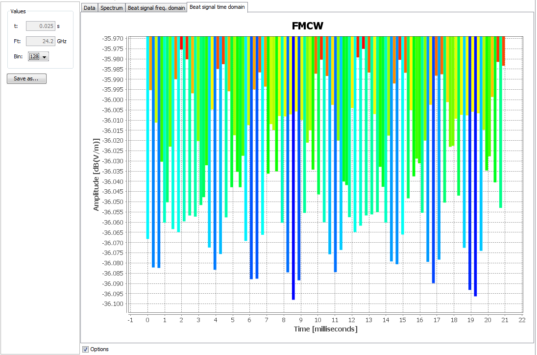

Save file and display the information about the FMCW spectrum with "Show Results --> Doppler --> FMCW". Select the function in the popup menu and press "Apply" button. The function will be displayed into the plot.
Introduce the time, for example t(s)=0.0225, to analyze and press "View FMCW Spectrum". Select the Bin into the popup menu to change the plots.
