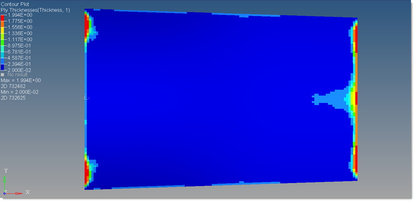

View the Ply Thickness Results
  1. From the Contour panel, set the Result type to Ply Thicknesses (s).
  2. Select the other plot options as indicated in Figure 6.
    3200ply_thick
    Figure 6. Ply Thicknesses Contour Plot
  3. In the Results Browser, select the last iteration.
  4. Click Apply.
    The thickness distribution of 0 degree super ply is generated. It represents the ply shapes and patch locations of the 0 degree ply bundles.
    3200_ply_thickness
    Figure 7. Ply Thickness Contour Plot . of the 0 degree super-ply

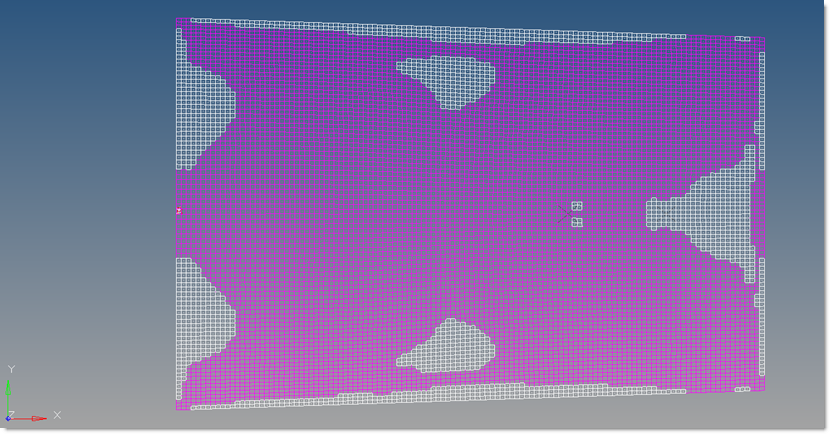

  4. From the Analysis page, click the entity sets panel.
  5. Click review and select set 5.
    set 5 represents the ply bundle 1 of the +45° orientation super-ply.
    Tip: You can review ply bundles in the Model Browser, Plies folder. Click any ply to view it's corresponding card data in the Entity Editor.
    3200_ply_bundle
    Figure 10. Element set 5 representing ply bundle 1 of the +45 degree super ply

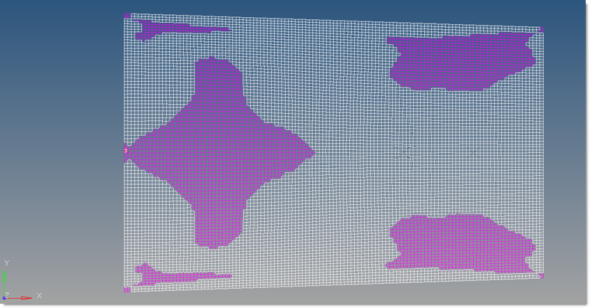

  6. Review the element sets 6 though 8.
    3200_ply_bundle2
    Figure 11. Element set 6 representing ply bundle 2 of the +45 degree super ply
    3200_ply_bundle3
    Figure 12. Element set 7 representing ply bundle 3 of the +45 degree super ply
