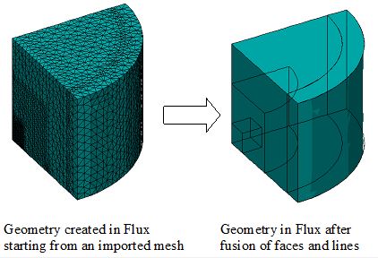

Two faces (lines) can be regrouped if they belong to same volumes (faces).
The mesh import of a quarter cylinder before and after the fusion of faces and lines is shown in the figure below.
