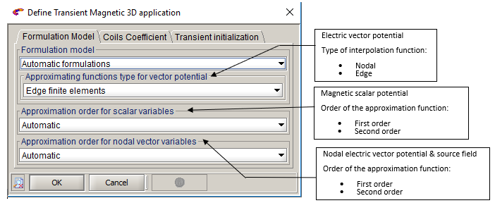

In manual mode
In manual mode, the user can modify the order (1st order / 2nd order) and the type of approximation functions (nodal type/edge type for the electric vector potential). These modifications are carried out in the dialog box of the application definition as presented in the figure below.
Advice
For a huge project, if the memory is not enough during solving process, it is possible to decrease the memory by choosing the vector variables approximation order of first order. It allows earning solving time and memory, despite a light results accuracy degradation.
