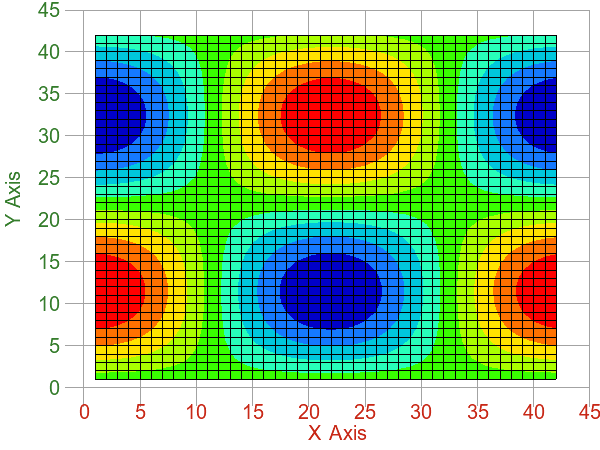

Examples
contour example:
cla;
x=[0:0.15:2*pi];
y=x;
z=sin(x')*cos(y);
contour(z);
Figure 1. Contour plot
