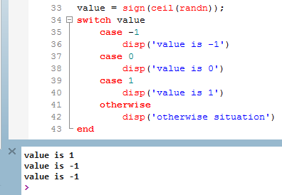

OML also supports switch/case/otherwise flow control. It’s
recommended that you use switch flow control when you need to consider multiple
situations in the script, as shown in the example below:
value = sign(ceil(randn)); switch value case -1 disp('value is -1') case 0 disp('value is 0') case 1 disp('value is 1') otherwise disp('otherwise situation') endsign(ceil(randn))picks a value from -1, 1, or 0. Results printed in the OML Command Window may be different when running this script:

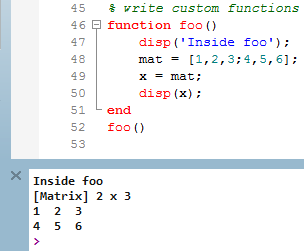

If you want to add a function to your OML script in the
Editor window, add the following code:
function foo() disp('Inside foo'); mat = [1,2,3;4,5,6]; x = mat; disp(x); end foo()This code first declares the function foo, then displays a message (
Inside foo) to notify that the function has been called. It then assigns the matrix [1,2,3;4,5,6] tomat.xis assigned tomat, then displaysmat. To call the function simple, addfoo()afterend, as shown below: -
Click Run to evaluate your script and see the output of
foo.

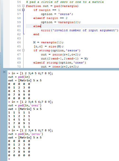

Below is an example of a function that contains a variable number of inputs, in
which case you can use the varargin function:
function out = pad(varargin) if nargin == 1 option = 'zeros'; elseif nargin == 2 option = varargin{2}; else error('invalid number of input argument') end M = varargin{1}; [r,c] = size(M); if strcmp(option,'zeros') out = zeros(r+2,c+2); out(2:end-1,2:end-1) = M; elseif strcmp(option,'ones') out = ones(r+2,c+2); out(2:end-1,2:end-1) = M; else error('invalid option') end endThis function pads zeros or ones 'around' the input matrix. The number of input argument could be one or two. The example below contains an input to this function, with the results below it:
