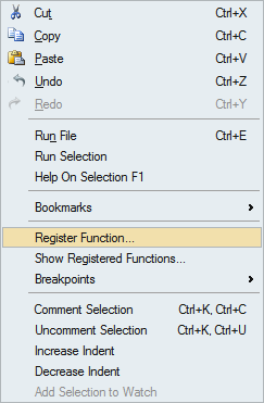

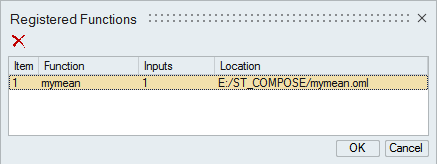

Registering OML Functions in Compose
This method allows you to automatically register OML functions directly from Compose.
To register a written function, make sure it is saved on disk first (*.oml file).

*SetOMLRootDir("E:/COMPOSE/Compose_2017.3")
*RegisterOMLFunction("mymean","E:/ST_COMPOSE/mymean.oml",1)where mymean is the function in the mymean.oml file and that function takes one argument as input.
