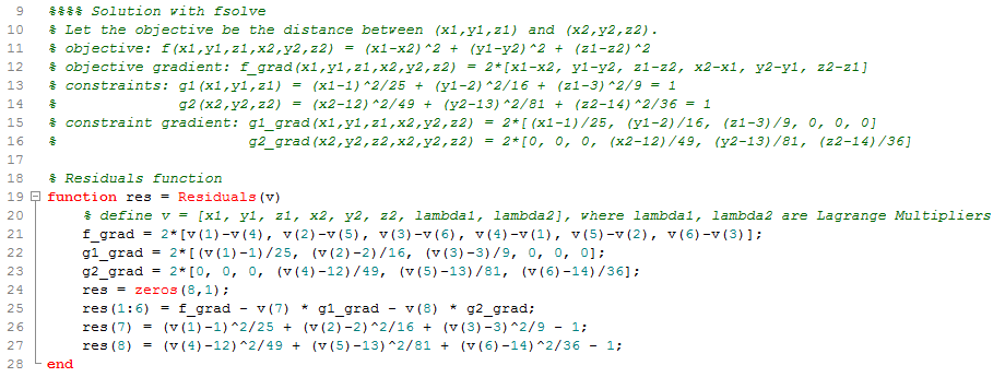

Create the System of Equations for Use with fsolve
Finding the minimum distance using fsolve is done with the method of Lagrange Multipliers. This method transforms the constrained minimization problem into a system of nonlinear equations.
The details are beyond this tutorial, but the basic idea is that the solution points have the property that the vector between them is parallel to both normal vectors on the ellipsoids at the points. The system of equations enforces the parallel conditions and the requirement that the points be on the ellipsoids. The result is a system of eight equations.

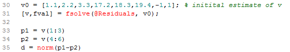

Define Initial Values and Solve Using fsolve
The fsolve function requires an initial estimate of the solution. For this problem, most estimates are adequate, but we choose points near the centers of the ellipsoids for convenience. (Choosing the actual centers would create too many zero values in Residuals.)
The points and the distance between them are as follows:

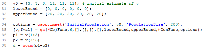

Define Initial Values and Solve Using ga
Trial and error shows that increasing the population size beyond the default produces a better result for this problem.
ga should not be expected to produce high precision results. It is best reserved for problems for which derivative based methods cannot be applied.

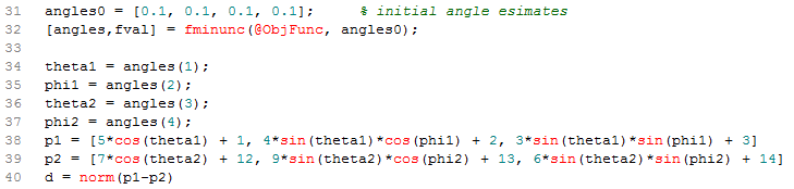

Create the Objective Function to Use with fminunc
To solve the problem with fminunc, it must be transformed into an unconstrained problem. To do this, you must re-parameterize the objective function in terms of the constraints so that a separate description of the constraint is no longer needed. This cannot be done in general.
Define Initial Values and Solve Using fminunc
fminunc requires an initial estimate for the angles. For this problem, most estimates are adequate, except zeros. The code looks like this:
