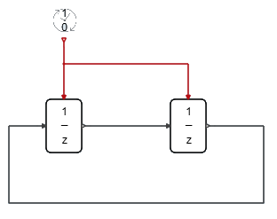

  3. From the Palette Browser, drag and drop the following blocks into your diagram:
    • From Activate > Dynamical, drag and drop two DiscreteDelay blocks into your diagram.
    • From Activate > ActiveOperations, drag and drop one SampleClock block into your diagram.

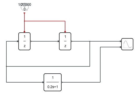

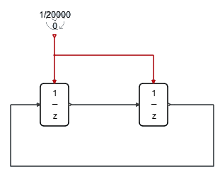

  4. Assemble and connect the blocks in your diagram as you see in the following figure:
  5. On the SampleClock block, double-click. In the block dialog, for the Sample period, enter: 1/20000, and click OK.
  6. On the block, DiscreteDelay, double-click. In the block dialog, for Initial Condition, enter: 1, and click OK.
    The discrete signal is constructed as you see in the following figure. The signal generates a square wave signal toggled between 0 and 1 at the frequency of 10000Hz.

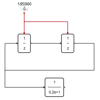

  1. In the Palette Browser, double-click Activate > Dynamical, and drag and drop a ContTransFunc block into the diagram.
  2. On the block, ContTransFunc, double-click. In the block dialog, for Coefficients of the numerator polynomial, enter: 1. For Coefficients of the denominator polynomial, enter: [0.2 1], and click OK.
    The ContTransFunc block represents a first order linear system that models the behavior of a simplified motor dynamics.
  3. Connect the block to your diagram as you see in the following figure:

  6. Connect the Scope block to the diagram as you see in the following figure:

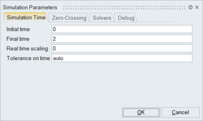

  1. On the ribbon, hover over the Simulate tool group , and click the Setup tool.
  2. On the Simulation Parameters dialog, for Final Time, enter: 2, and click OK.

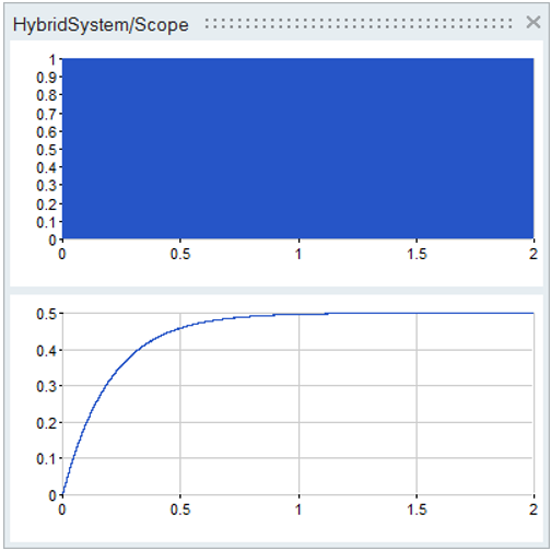

  1. On the Scope block, double-click.
    A Scope window opens. Because the Scope block is defined with two inputs, two corresponding subplots are displayed, representing the square wave signal and system response, respectively. Because the frequency of the square wave is 10,000Hz, too many periods exist in the time span between 0 and 2 seconds, therefore zooming into a smaller range is required.
  2. To reveal the square wave form more clearly, on the X-axis of the upper subplot, right-click to launch a floating panel.
  3. For the upper limit value, enter 0.001.
  4. On the Y-axis of the upper subplot, right-click. In the floating panel, for the lower-limit value, enter: -2; for the upper limit value, enter: 2.
  5. To fit the view of the plot in the window, on the lower subplot, middle-click.
  6. To zoom in on an area in the plot, press the Ctrl key + middle-click + drag to select a frame on the plot.
    The area in the frame appears in the lower plot as you see in the following image:
