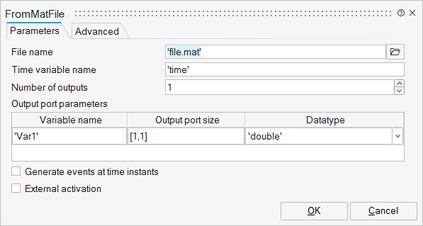

FromMatFile_0
fname
File name
Defines the name (path and full name, in between quotes) of the input .mat file.
timename
Time variable name
Name of the variable in the data structure that contains the time values. If no name is provided, the time variable is not exported.
nout
Number of outputs
Number of data channels to be read in the MAT file.
Their dimension must be consistent with the dimension on the Time variable.
outports
Output port parameters
Structure
outports/varname
Variable name
Cell of strings
outports/outsize
Output port size
Cell of matrices
outports/ot
Datatype
Cell of strings
'double'
'complex'
'int32'
'int16'
'int8'
'uint32'
'uint16'
'uint8'
'boolean'
'inherit'
outevent
Generate events at time instants
This parameter defines if the block generates an activation event. When OutEvent is used, a additional event output port is added to the block. default is OFF.
externalActivation
External activation

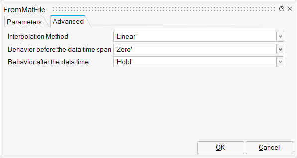

Method
Interpolation Method
Defines how the data read in is interpolated. Options are "zero order" or "linear".
'Zero-order'
'Linear'
'Not_a_knot'
'Natural'
'Clamped_To_Zero'
'Akima'
'Fritsch_Butland'
'Steffen'
Leftside
Behavior before the data time span
'Zero'
'Hold'
'Extrapolation'
'Repeat'
Rightside
Behavior after the data time
'Zero'
'Hold'
'Extrapolation'
'Repeat'
