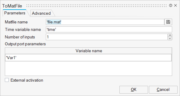

fname | Matfile name | Name of the MAT file. | String | |
tvarname | Time variable name | Name of the variable in the data structure that contains the time values. If no name is provided, the time variable is not exported. In this case, the external activation should be enabled to store data at event instants. | String | |
nin | Number of inputs | Number of data channels to be writte in the MAT file. | Number | |
inports | Output port parameters | Structure | ||
inports/varnam | Variable name | Cell of strings | ||
externalActivation | External activation | Specifies whether the block receives an external activation or inherits its activation through its regular input ports. When External Activation is selected, an additional activation port is added to the block. By default, external activation is not selected. | Scalar | 0 |

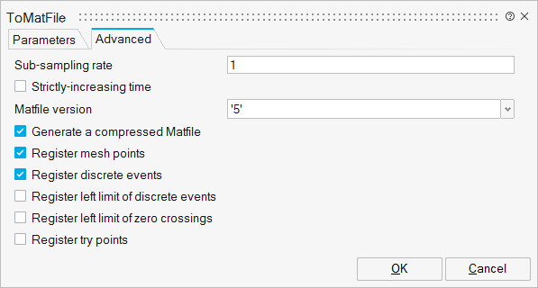

subsample | Sub-sampling rate | Sub sampling rate should be greater than 1. | Scalar | |
increasingTime | Strictly-increasing time | Select for the block to create a strictly-increasing time sequence. | Number | 0 |
matfileversion | Matfile version | String | '5' | |
Compressed | Generate a compressed Matfile | Default is ON. | Scalar | 0 |
R_MP | Register mesh points | Register the continuous time step. Event code is 0. | Number | 0 |
R_DE | Register discrete events | Register the discrete time event. Event code is 1. | Number | 0 |
R_MPLL | Register left limit of discrete events | Register the event just before a discrete event. Event code is -1. | Number | 0 |
R_ZCLL | Register left limit of zero crossings | Register the event just before a zero crossing event. Event code is 4. | Number | 0 |
R_TRY | Register try points | Register the events in try phase. Event code is 2 or 3. | Number | 0 |
