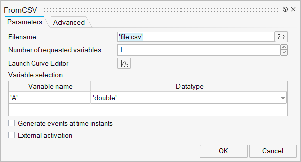

The FromCSV block enables data reading from CSV (comma separated values) files. The first line of the CSV file should indicate the variable names. It is mandatory that the first variable name is "time". This is, for example, compatible with the FMU result files.
The block will read as many columns as specified by the first parameter (Number of requested variables). The columns are identified by their name (located on the first line, passed as a string).
FromCSV_0
fname
Filename
nout
Number of variables to read in the .csv file. One variable corresponds to one column.
outports
Variable selection
Structure
outports/varname
Variable name
Name of the variable to read. String corresponding to the column name (first line).
Cell of strings
outports/vardatatype
Datatype
Cell of strings
'double'
'int32'
'int16'
'int8'
'uint32'
'uint16'
'uint8'
'boolean'
outevent
Generate events at time instants
Specifies if the block generates an activation event. When OutEvent is used, an additional event output port is added to the block. Default is off.
externalActivation
External activation

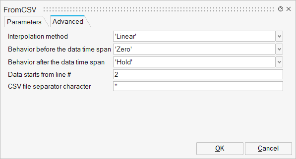

FromCSV_1
Method
Interpolation method
Defines how to interpolate the data that is read in from the .csv file.
'ZeroOrder'
'Linear'
'Not_a_knot'
'Natural'
'Clamped_To_Zero'
'Akima'
'Fritsch_Butland'
'Steffen'
Leftside
Behavior before the data time span
'Zero'
'Hold'
'Extrapolation'
'Repeat'
'Error'
Rightside
Behavior after the data time span
'Zero'
'Hold'
'Extrapolation'
'Repeat'
'Error'
Offset
Data starts from line #
Line from which to start reading the .csv file. Default is 2.
Separator
CSV file separator character
Enter a separator character in this field. If the field is left empty, the default separator is the first character that follows the variable time in the first line of the .csv file.
